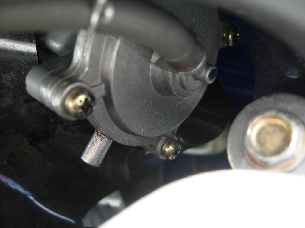

Wait a minute, you have had the tank off?????
If yes, you need to check all your connections to the tank are proper. The most common error is people connecting the little tube to the lower nipple on the petcock without looking for the proper connection farther back. After you take the tank off a couple - three times, then you get it. It's just a vac line but it's got to be in the right hole.

drew_c14's Avatar
Posts: 2,455
From: Williamsburg, VA
see above post...

Took the tank off twice - third time since I bought it, I believe I got the tubes in the right place - yes, there's that downward pointing connection with no hose, weird.
Old Jul 31, 2009 | 07:39 PM
Make sure you don't have the little hose that goes into the bottom of the tank reversed with the one that goes to the back of the petcock. They are approx the same length and diameter and could be inter changed.
