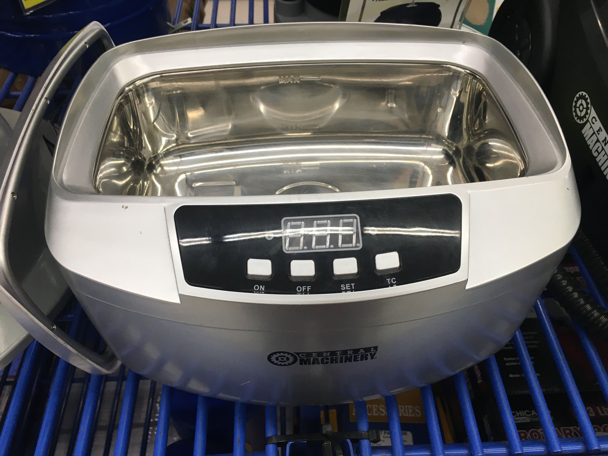

Old Dec 11, 2020 | 02:45 PM
tosainu1's Avatar
Joined: Aug 2019
Posts: 22
From: Md
tosainu1 is on a distinguished road
Ultrasonic cleaner
Went to harbor freight and bought me an ultrasonic cleaning machine to see if that will fix the problem
