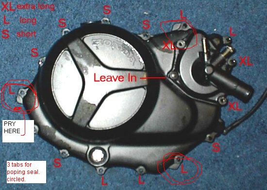

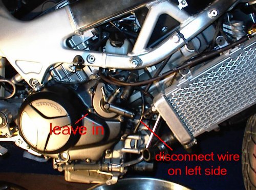

Ok heres some info i used when i took my cover off to replace my ign advancer this will prolly help you
This is a hacked version of how to replace the ign wheel on gregs liter bike site. I take NO
credit for any of this information.

3) Remove the 2 top bolts for the radiator and the one from behind it.
4) Remove all coolant hoses from the water pump cover.
5) Loosen/remove the 16 bolts from the side cover, there's one bolt for the water pump that can stay in, it threads into to the cover, not the block. I made a note of sizes and locations at the bottom of this.
6) Follow the wire for the Pulse Alt Starter Switch to the left side, bottom of the radiator, and disconnect it.
7) Pull the wire out through the right side.
8) Pull off the right crank case cover, set it aside. Small amounts of coolant and oil will drip out, so be prepared
After doing all of that you will have to pry the cover loose from the back theres a little tab
you can get a common (flat) screwdriver under to pop the seal on the case gasket.
Carefull not to pry top hard and tweak the water pump shaft on the front of the cover.
see the attached pictures for refence. hope this helps.
