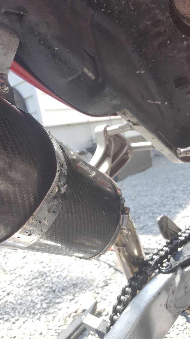

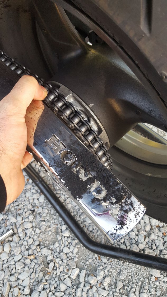

My chain appears to be shredding the sidewall on my tires.
I got about 3 - 4000kms on these new tire before i started to notice this slight wear. Two or three days later, they looked like the above picture.

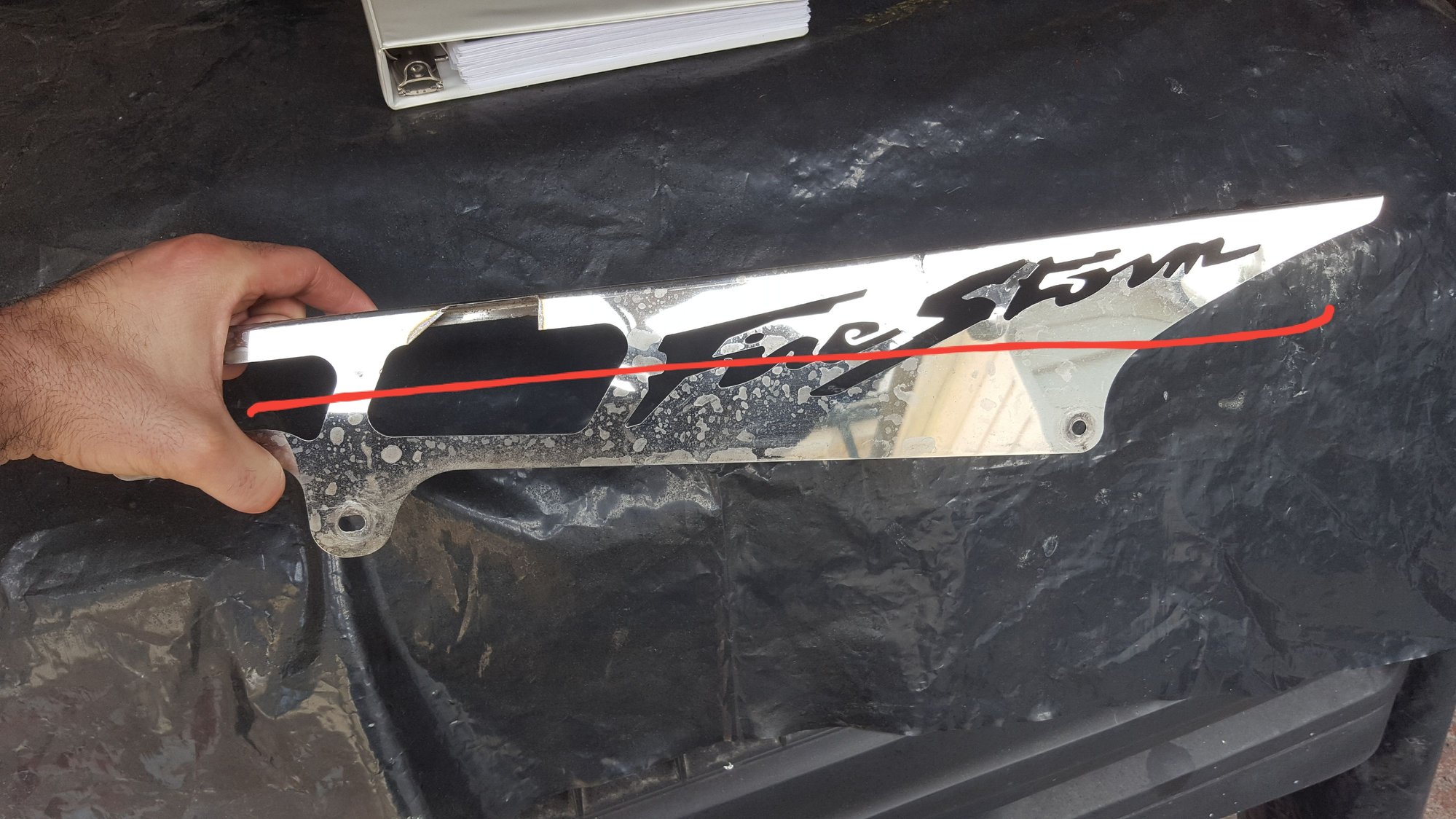

I thought it had to do with an aftermarket chainguard I installed, and ai was actually going to make a separate post about them, becausr Ive had nothing but problems with them, but I switched back to the stock plastic one and it still got worse.I changed my chain and sprockets, (which I've done before with no issue, stock size, 550 DID riveted)

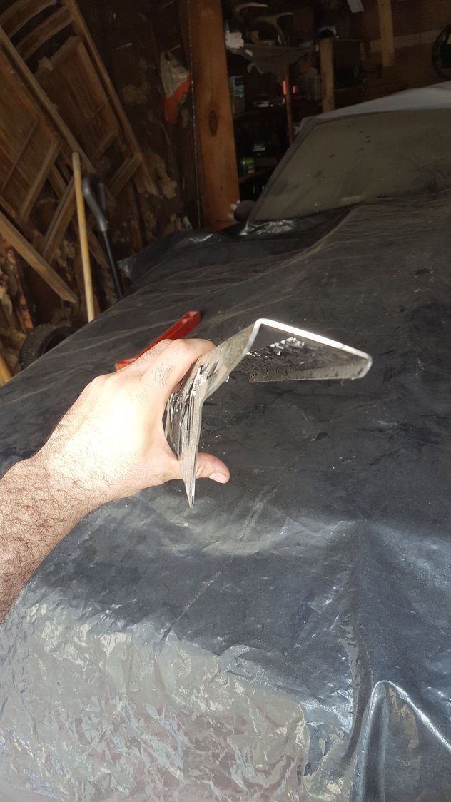

The aftermarket chain guard kept bending and breaking, but along the reline axis...inward toward the tire.

So is the chain hitting the tire or the chainguard?

Sorry to trouble you cap. It turns out, stainless steel passenger peg spacers I made, weren't quite out far enough. This was causing my exhaust hanger to rub on my tire....what a costly mistake...
I still don't know why the chain uard bends and breaks, but I suspected it was the culprit until I changed it back to the stock one, and the tire still got shredded. I thought the information may have been relevant to a diagnosis, ie, swingarm or some such issue
