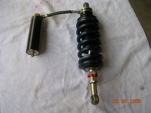

Try to pickup a second hand leaky Penske on the cheap cuz they are totally rebuildable!

This used Penske was picked up for $199.00 on Ebay
http://cgi.ebay.com/ebaymotors/Pensk...item2eaceb67db
