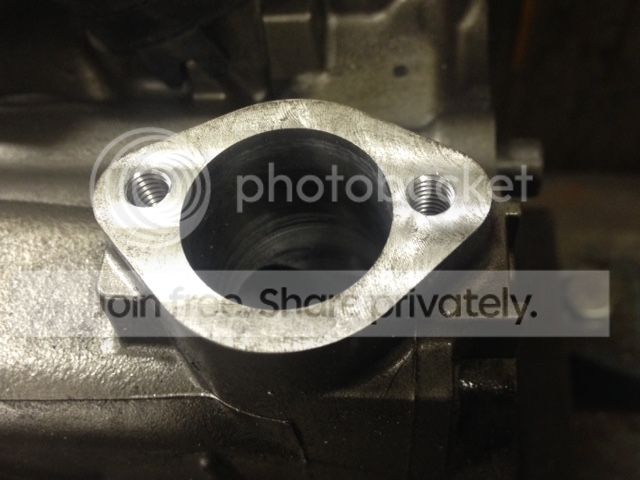

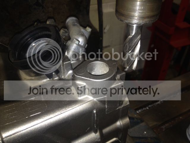

Using a Rear Head for the Front Cylinder. I know it's been discussed a few times before, but never attempted that I know of. I got my old Bridgeport mill running today and decided I would try it on a rear head I had on the shelf.
Comparison: The castings look the same, with only the Cam Chain Tensioner location being different. On the rear head, the CCT mount blank is there, but it's a rough casting.

The first thing I needed to do was machine the face flat where the gasket seals. The lucky thing was that the two opposing CCT mounts are parallel. This made it easier to mount the head on the table with the CCT blank level. I put the biggest mill in I could find and had to make a few passes to clean up the surface.

The next step was to bore the hole where the tensioner would go into. The other CCT hole measured about 0.985". I didn't have a bit that precise, but I found a 1" drill bit I could use.

I used a gasket to measure the hole spacing. I put the gasket in place and located the first hole by hand, then using the measurement I took I moved the table and drilled the second hole, followed by tapping them for the M6 bolts used.

I tried bolting on the Manual CCT I had on hand and the bolts were just a little wide. My measurement was a little off. I drilled the MCCT holes a little to 1/4" and it bolted up.

Looks to me like it's going to work. Next I'm going to make a cover for the unused CCT mount on the other side of the head.

There is no reason that will not work.. quite simply, all the CCT does is push against the chain guide.. You could almost just drill a hole in the non machined casting and tap it, then thread a bolt in to push against the guide... Not enough materiel thickness in the rough casting at the unfinished CCT hole to do that reliable, but you get the idea.

Just to clarify, I will NOT be putting two CCT's on....you never know who might read this and take it seriously...The CCT needs to be on the loose side of the cam chain. With the motor rotation being counter clockwise when viewed from the left side the cam chain is loose towards the rear of the motor. So when you rotate the rear head 180* to put on the front cylinder you need the opposite side CCT location.
