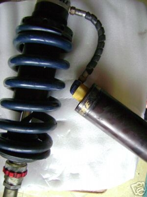

Dude, one of the biggest problems with a stock SH is the rear shock. You could run a 2x4 back there and get better results!
Here's a pic of the Penske shock I went with and now the bike soaks up bumps like they aren't even there
Good luck,
RC
