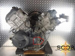

leak at red circle?
if so water pumps seal.

When was the last oil change? do you have mcc't? might be a leak from the combustion chamber to the water jacket. This could be the cause of leak, as for heaing a taping sound that is the puzzing part. or Bad water pump, before the bike get up to 160 the thero doesnt open putting more presure on the pump causing it to keeping quite. but once the presure is released the pump makes noise. these are all guesses. Your going to need someone to dig into it before it gets worst or drive it until whats making the noise flys out the side of your engine. JK, dont do that.

Wrong...The pressure cap, not the thermostat, determines cooling system pressure. If coolant is coming out of the water pump vent hole, the seal is bad. You need to pull the clutch cover, then new seals need to be properly pressed in.
And the screwdriver method I mentioned above will help locate the source of the noise. It can be used on the water pump as well.

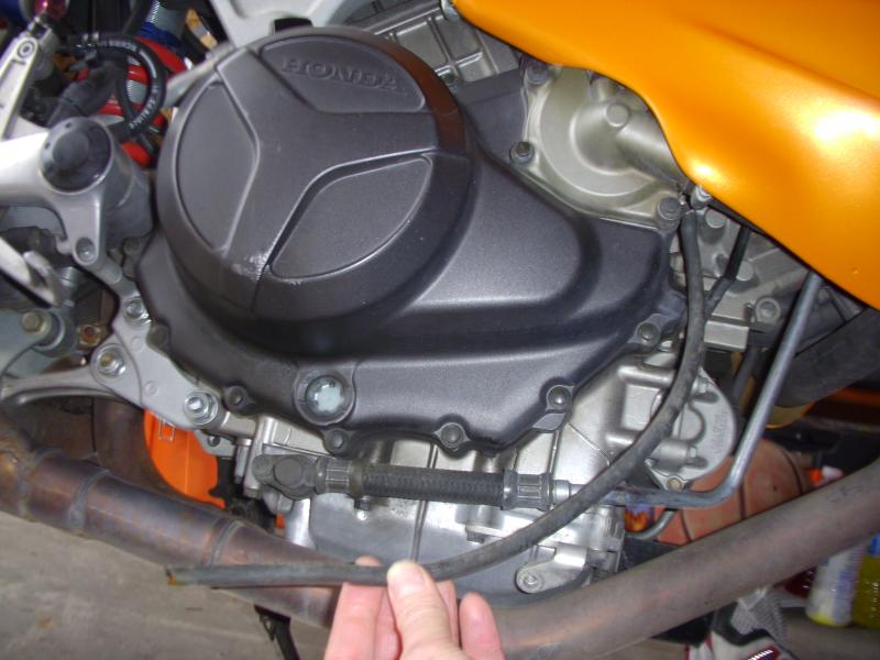

Coolant drip
Here is a pic of the hose that drips..It is literally only a few drips tho? Have been tracking down a battery drain also so I have started her a few times..She is dying when I put her into gear now????

yerp water pump seal is bad

Expensive?
Old Apr 27, 2011 | 08:59 AM
hawxter996's Avatar
ole dirty bastard
Posts: 976
From: my house
Originally Posted by newbierider77
Expensive?
not sure on price of seals,labor is what usually gets you.
save some labor by removing cover yourself and take to local shop.
should be under 1 hour labor.
