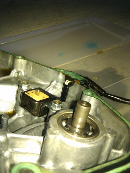

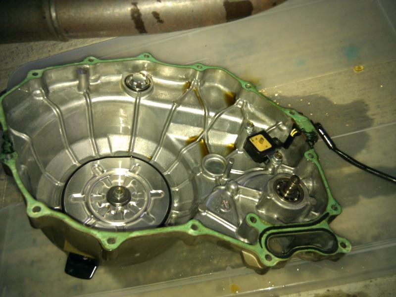

But I have found the source.... It seems the water impeller shaft has sheared off... see images. The question now is where the F is the bit that is no longer attached... I think it may have fallen out the back of the water pump gear, but that looks like its gonna be a real pig to remove....
Attached Thumbnails Post Winter Overheating Issue-2010-05-04-19.52.53.jpg   Post Winter Overheating Issue-2010-05-04-19.53.00.jpg

Going back to the original post, what has been done to shear the pump shaft? That's something that really surprises me...
Old May 8, 2010 | 08:56 AM
thatbloke's Avatar
Posts: 15
thatbloke is on a distinguished road
I believe the cause of this is stupidity on my part.. I had to move the bike in the middle of the winter (I'm in Chicago so it was well bellow freezing) but did not do any suitable winter prep before the cold set in.... And as such she was left with water wetter in and no antifreeze....
I think I have learnt a valuable lesson here.... Either find heated storage for the winter or stop being lazy and do the prep work...

What was the coldest you started you bike? and when you checked the coolant was it neon green or slightly green or all water?
If you where to start the bike and it was frozen due to no anti freezing agents it would snap the WP shaft.
