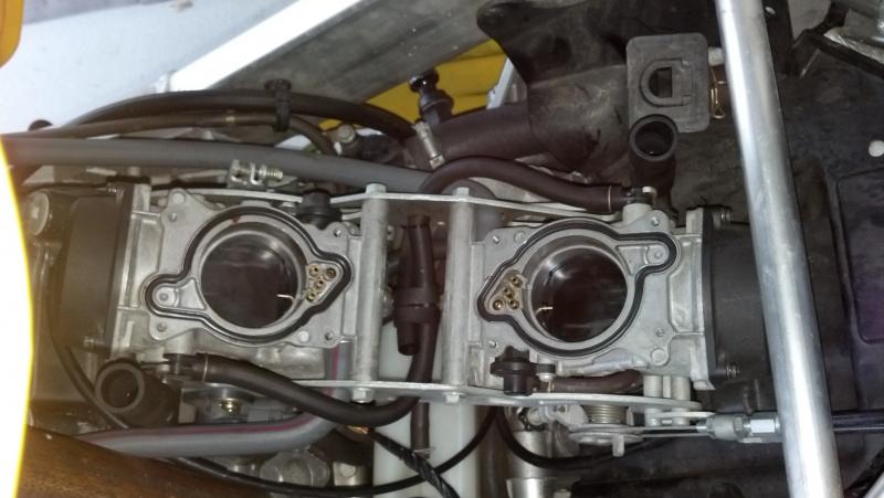

OK before I get a bunch of " use the search" or other grief I just wanna know what I have. Went to disable and remove the PAIR system today and when I lifted the tank and removed air box I noticed that there was no vacuum lines anywhere and when I found what I believe was the PAIR it has TBR block off plates.
Am I correct?

Also as far as the carbs, notice the middle and the two vacuum lines together, do they need to be caped off? Right is front of bike.

And if you look at the upper portion of the pic there is some bulky plastic thing attached to a big hose going to the top of the valve cover, dont know what that is and why it would be just sitting there. There is one for the rear valve cover as well. To me it looks like someone disabled and removed the PAIR and installed block off plates, caped the bottom of the air box, but didnt finish the job. Maybe?
Oh if the PAIR is removed and disabled why would my SH still pop on decel?

Yep, the PAIR system is gone. Don't cap off those hoses in the center of the carbs. You can stop some of the stumbling and the bike conking out on hard braking by turning the hoses downwards.
That hose from the front valve cover should be attached to the bottom of the airbox... that clip looks pretty odd???

Ok. Bike runs strong. Little bit of "lean burp" if you will at a steady cruse around 3k. Still pops on hard decel.
The "big plastic thing" in the 3rd pic is also the same on the rear valve cover attached to a big hose. All leads on the bottom of the air box are caped, except the ones leading to the triangular areas inside the air box. Which are the short hoses coming from the carbs to the triangular areas.
Should I reconect the big hoses to the bottom of the air box?

I'd reconnect them, unless somebody else knows whats up with those clips?
I know its not like that on my hawks?

Hey Matt, Whats weird is on the air box there is no spot for those big block looking things. Almost like someone installed those to replace attaching the hoses to the air box. Cause the corresponding connection on the box are caped. Hmmmmm???

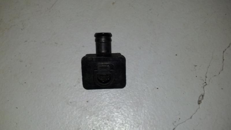

OK so I got the one out of the rear crankcase vent hose.
Here-
Hose seems to be ok and I can reconnect to the air box. Front one is gonna be a bitch to remove and I can see that it will be a PITA to connect to the box.

Did notice this large plastic plate over the front valve cover and the front hose routes through, all most seems easier to remove the plastic cover (plate) and there would be a lot more room to get a hand in there. Just a thought. It can be seen in the first post 3rd pic.

Those are the crankcase vent hoses. It looks like someone put automotive type crankcase breather filters on the end of the hose. I would remove those and hook the hoses back up to the airbox, to make sure you're getting clean filtered air into the crankcase.
Check the fit first, to make sure the PO didn't cut the hoses. The front one is a pain to attach to the airbox and install the hose clamp, unless you've got kid size hands. I've found that removing it from the valve cover end makes hookup to the airbox easier, then reattach it to the valve cover.
That was my guess as well. Glad you chimed in.
Your right about the small hands thing. I'll try connecting to the airbox first and the valve cover second the next time I pull the airbox.
00SUPERHAWK, if the P.O. put the breathers on the valve cover breather hoses, did they plug the inlets to the airbox?

Yes, all the inlets on the air box were caped or plugged, except the inlets for the triangular areas those were connected.
