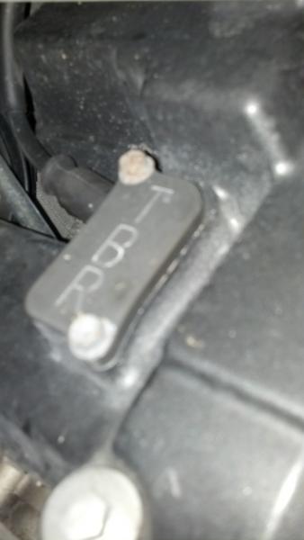

OK before I get a bunch of " use the search" or other grief I just wanna know what I have. Went to disable and remove the PAIR system today and when I lifted the tank and removed air box I noticed that there was no vacuum lines anywhere and when I found what I believe was the PAIR it has TBR block off plates.
Am I correct?

matt365 02-25-2012 02:34 PM
Yep, the PAIR system is gone. Don't cap off those hoses in the center of the carbs. You can stop some of the stumbling and the bike conking out on hard braking by turning the hoses downwards.
