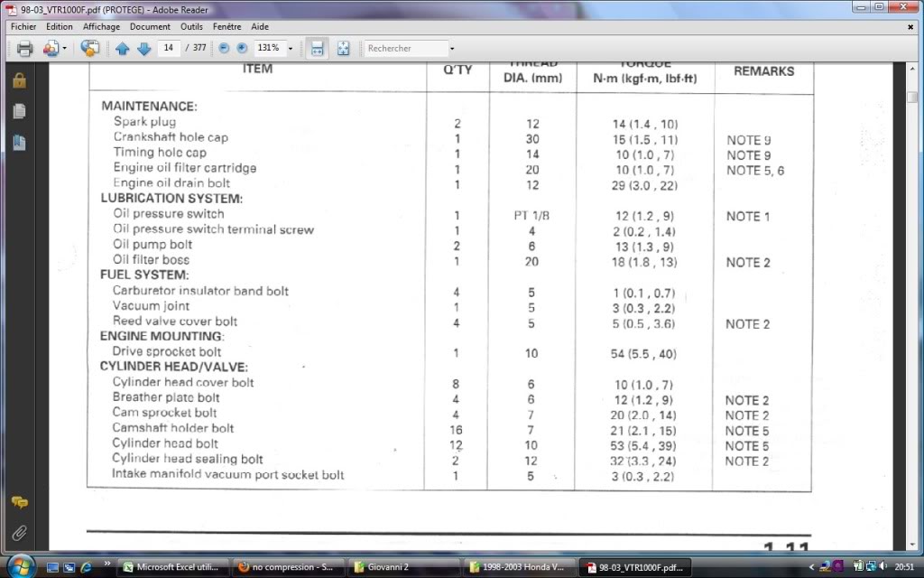

Since I was not 100 % sure, I had to verify and it's not a M6 bolt, it's 7 mm and it's 14 lb/ft, note 2 stand for apply locking agent to threads
Old Jan 18, 2010 | 06:44 PM
spladle160's Avatar
Posts: 380
From: Warrenton Virginia
I think it's actually the cylinder head sealing bolt, not sure how I missed that page in the manual
