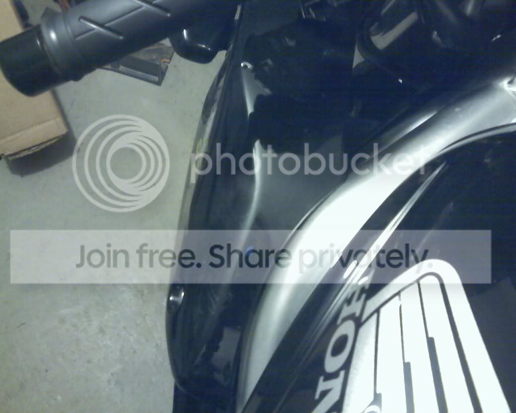

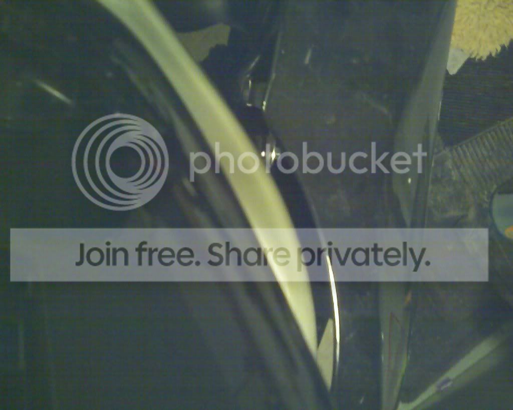

Old Apr 15, 2009 | 04:50 PM
Iron Crotch's Avatar
Joined: Apr 2009
Posts: 44
Iron Crotch is on a distinguished road
Does this look normal to you? Or should it be symmetrical? On the left side the fairing is touching the frame and on the right side there is a small gap.
Old Apr 15, 2009 | 04:56 PM
Um... No, not entirely... There could very well be a difference, but that much suggests that the front fairing stay might be a bit twisted... It's the elk horn thingy holding the gauges...
It's really nothing to be alarmed about, if the bike looks to be repaired in an otherwise professional manner it should be fine... But it does suggest that the bike may have been down sometime earlier in it's lifespan...
I'd start by loosening up all the bolts and wiggling the fairing to make sure it's just not ill adjusted at the bolt holes, but with that much difference I doubt it...
Old Apr 15, 2009 | 05:54 PM
WAYNEHAMMER's Avatar
Joined: Apr 2009
Posts: 55
From: oxnard CA
WAYNEHAMMER is on a distinguished road
one of the mounting brackets for the side fairing is probably just bent. that hapened on mine you can just bend it back..
Old Apr 16, 2009 | 10:28 AM
Joined: Apr 2009
Posts: 44
I'll try to unbend it this weekend while changing the exhaust and spark plugs.

Old Apr 18, 2009 | 12:54 AM
loserbaby's Avatar
jet wrench
Posts: 175
From: cowtown, CA
loserbaby is on a distinguished road
Looks like your fwd fairing bracket is tweaked... between the headlight and gauge cluster...
It can be tweaked back.
LB
Old Apr 25, 2009 | 09:26 AM
Joined: Apr 2009
Posts: 44
Alrighty, just got done fixing the fairing, it was pretty easy, I just bend it back the support to its original position and voila! I've also installed the Hindles, but the clamps for the stock exhaust do not work on them. The hindle slid right over the header, and is not air tight, so I was wondering if I should use a smaller collar although I'm not sure it will work since the end of the pipe doesnt have grooves on the end of it like the stock unit. Should I put exhaust sealant in there?
