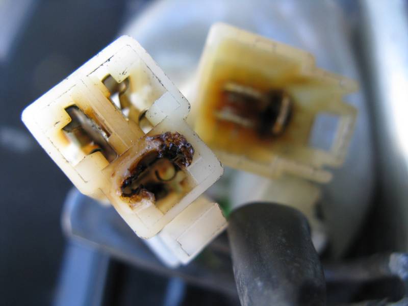

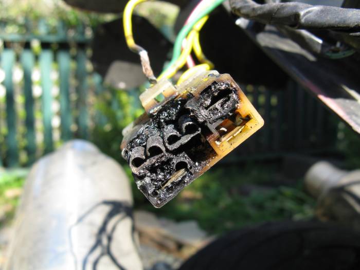

  • Checked the R/R: 2 of the connectors were badly burned
  • One of the big white connecters with 3 yellow wires near the battery: wires are badly burned on one side

as bad as this
Attached Thumbnails More interesting electrical/regulator issues.... Help!-rnr-conector.jpg   More interesting electrical/regulator issues.... Help!-stator-connection-tank.jpg

No, not that bad! That is scary! The R/R connector looks more like this (this is another site though the connector looks just like this):
http://www.vlc.com.au/~justin/about/.../dead_reg.html
The 3 point connector is also burned, but not as bad as yours!
I think I will replace the R/R regardless, not sure what to do about the connector. Any thoughts?

Im sure you need a new R/R, get on that right away cause it takes time to order it.Electrosport dosn't have any at the moment.Take care of that R/R plug, its irreplaceble.I had a failure a year or so ago that lightly toasted my R/R plug like in your picture obviosley it got hot.I suspect melted wire insulation+ corrosion+ vibration=my above trophy pics.
