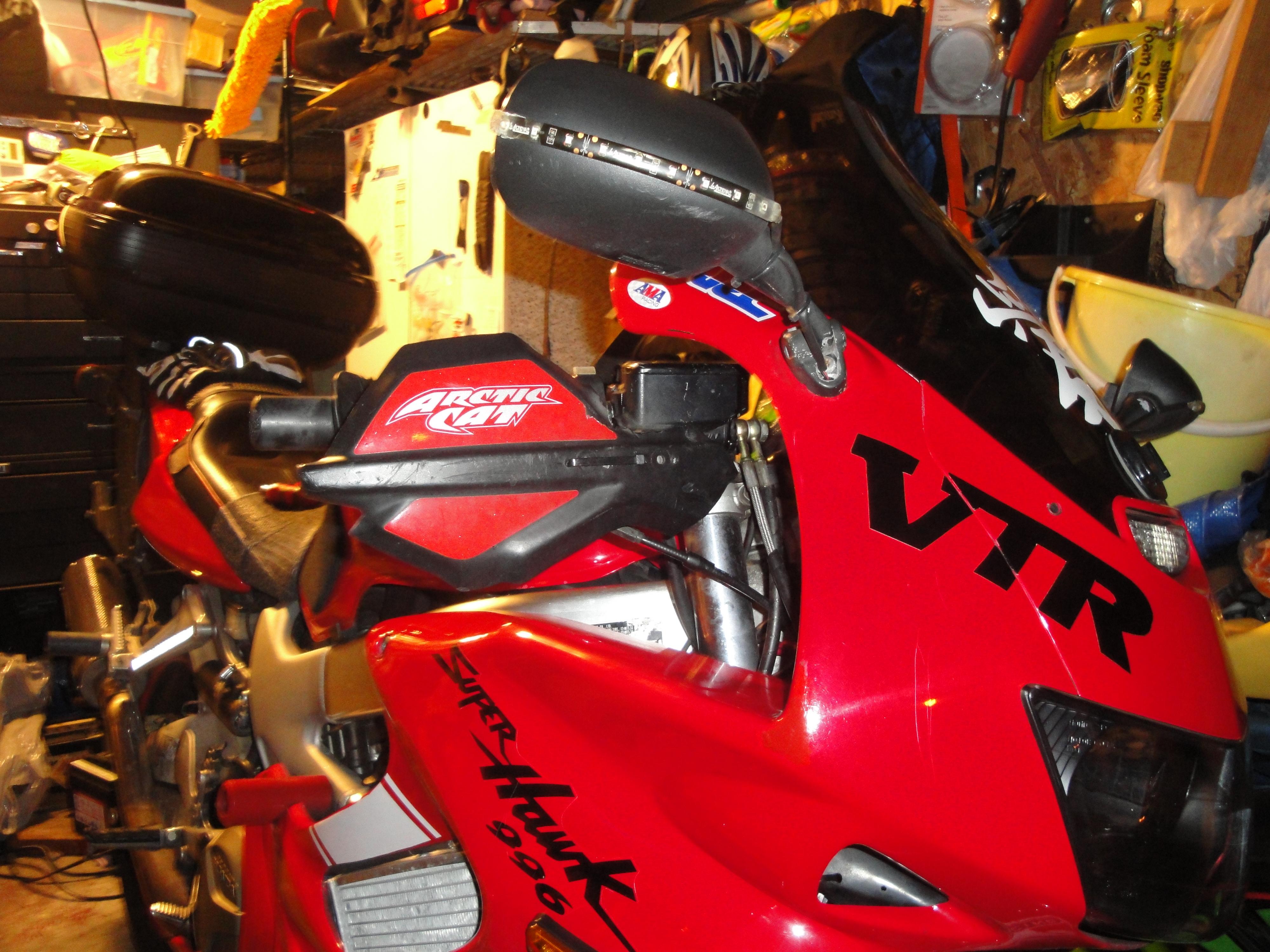

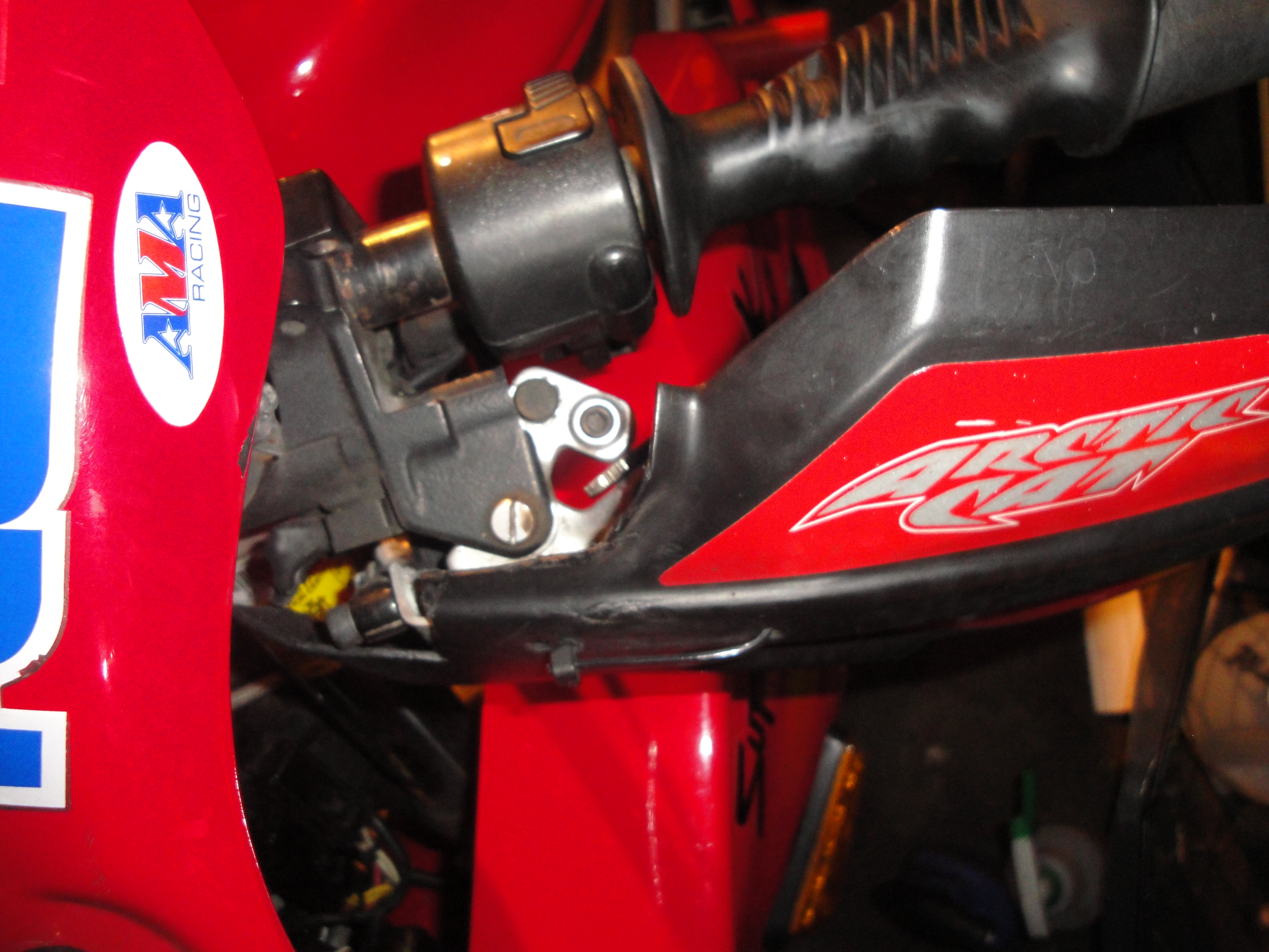

Skokie on the artic cats, they replace the back side of the clutch and brake perch. So on one side you just need to drill a hole to line up with the Honda position.
Then you cut the forward reaching arm and drill and bolt it back together at the length and angle that works for you setup. I can take pics. Its not a simple bolt up but once on its pretty invisible.

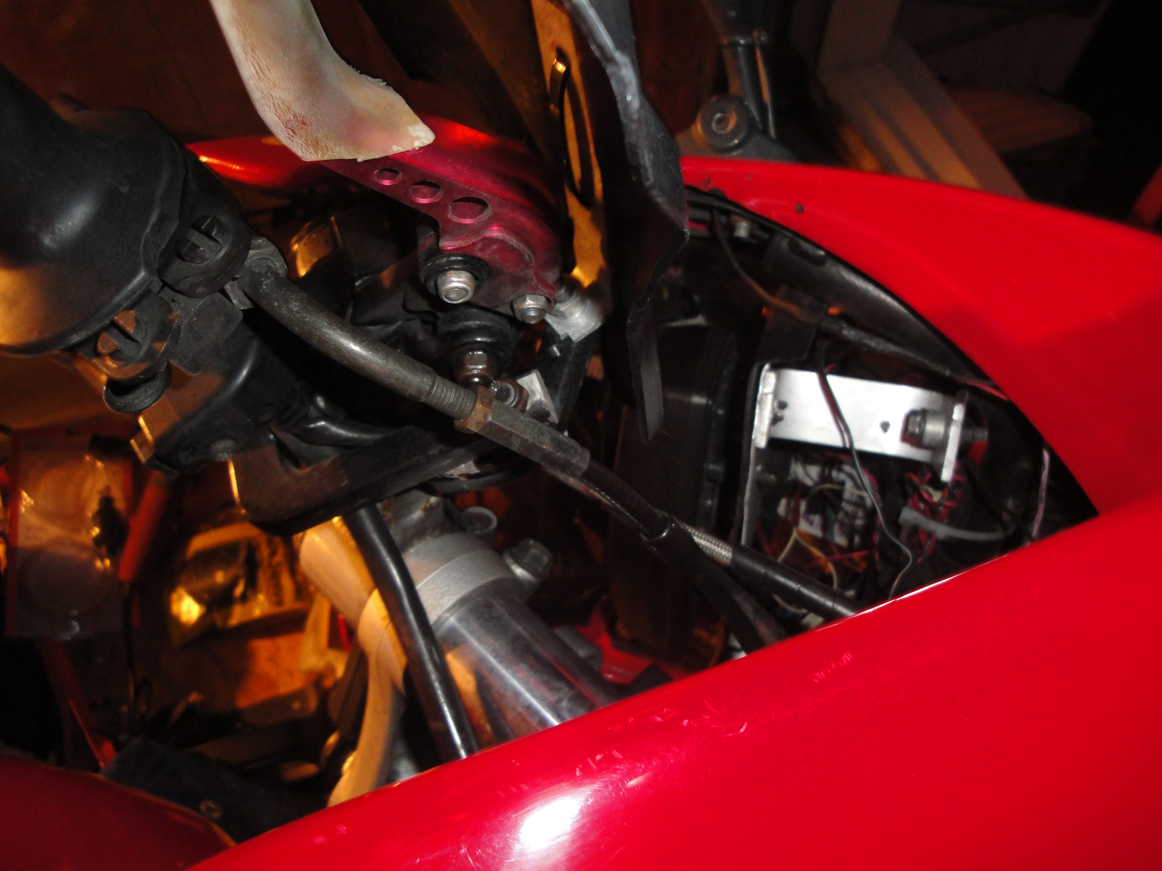

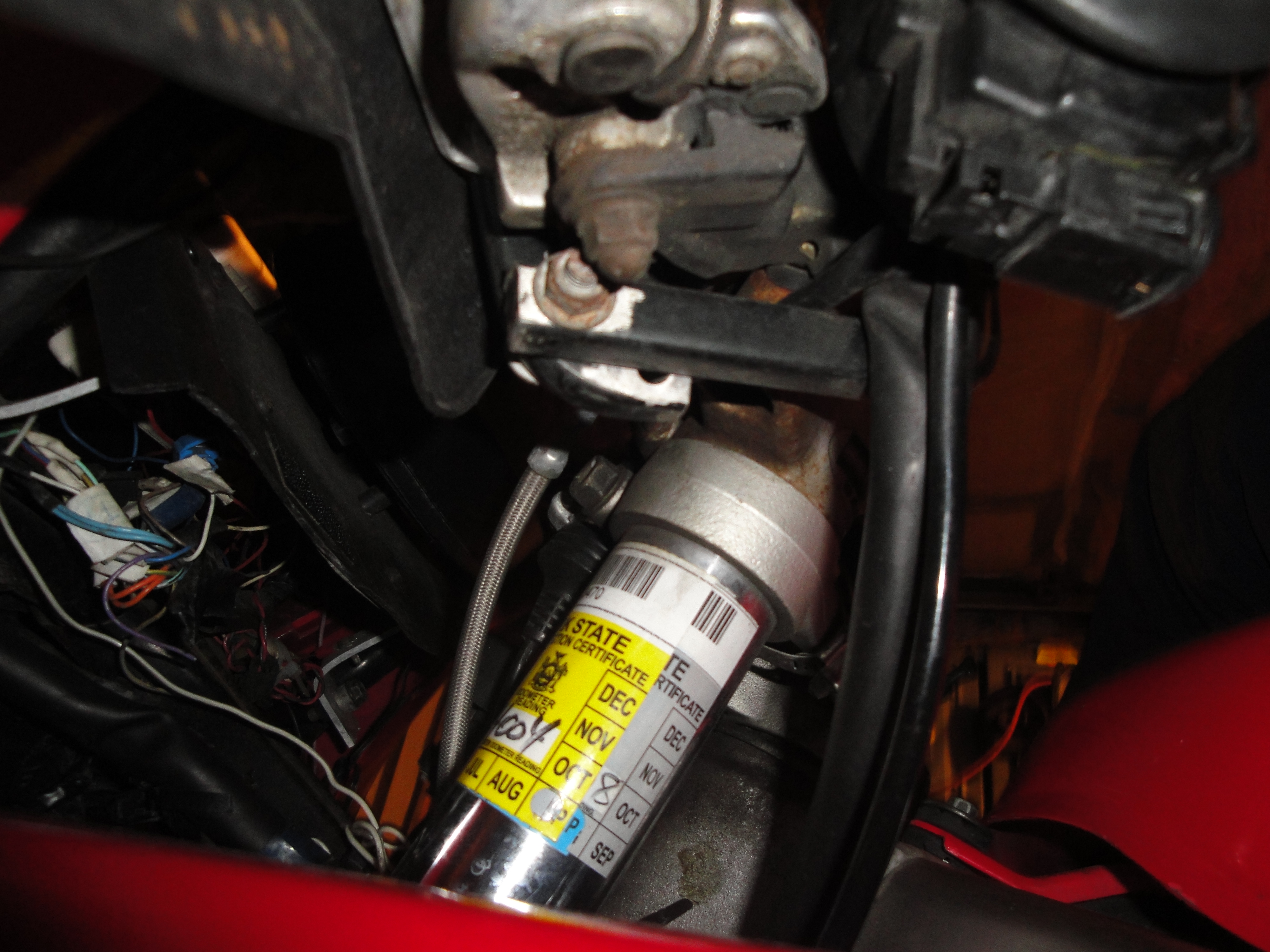

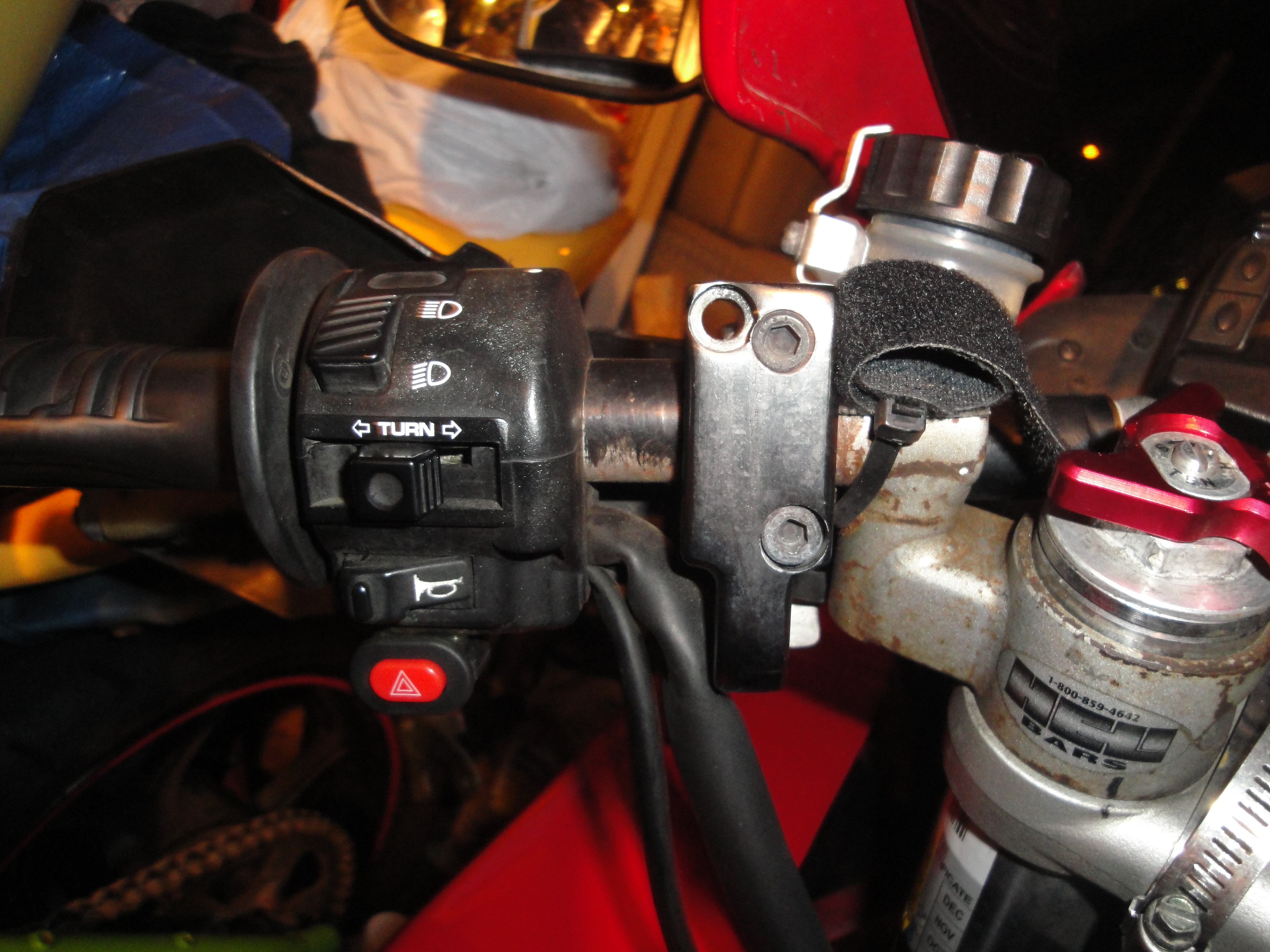

Ok with much wailing and gnashing of teeth I got some somewhat bad pics. But you should see the ones that didn't make the cut. These just show how I cut the support at the bend, drilled both pieces and created my own angle and length.(sorta)
It also shows how I had to drill to let them act as the back half of the clutch perch. (they come with the holes in the wrong spot)
