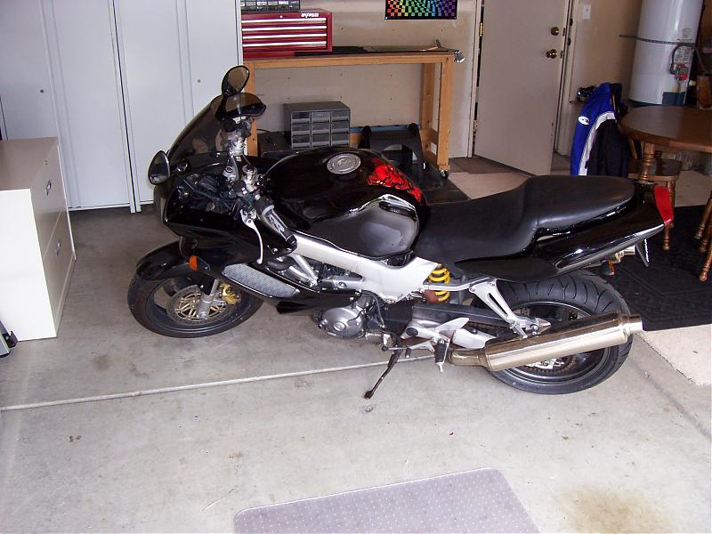

So I just bought a 98 Superhawk and I am VERY pleased with this purchase...
This bike handles and rides like a dream, corners like a champ and WOW talk about low end torque!! after about two weeks of riding I think I have downshifted ONCE to pass somebody.
I am coming from a 93 VFR750 and thanks to a run in with a deer on Foothill Rd in Pleasanton, CA that bike is now soda cans...hehe

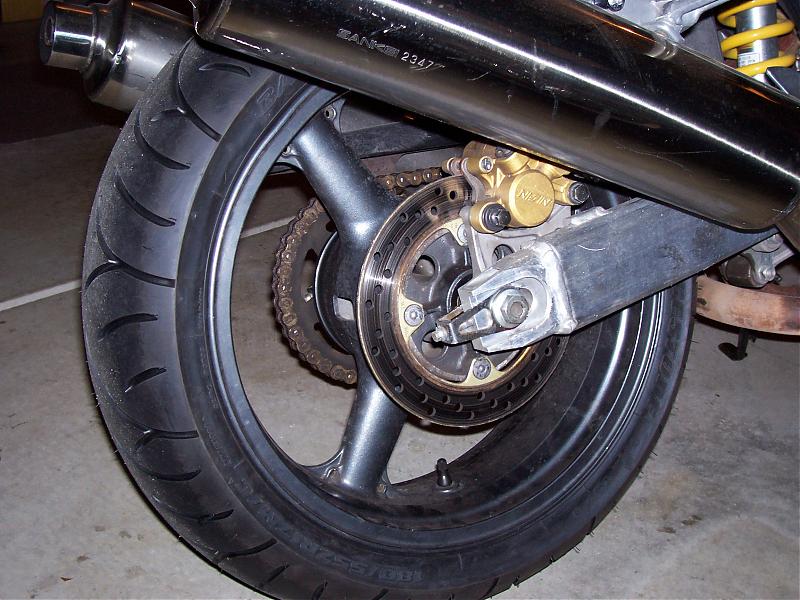

#1) The mechanic who swapped out the rear tire said it was a bitch to get on and the wheel probably wasn't from this bike. It looks like the superhawk used a 5.5" wheel and a 6" is whats on there now (with the 5.5" wheel spacers i believe) Sooooo Are there any 6" wheel spacer adaptor kits around? Does this wheel even look like a VTR wheel?

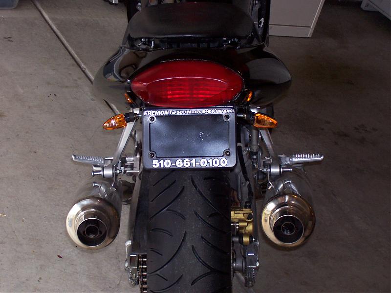

#3) As you can see in the custom (ie: homemade) fender eliminator the seat lock was removed. The guy before me took a hack saw to the rear fender/license plate/turn signals. Does this matter?
#4) The front turn signals were also missing, I ordered some online, but when they arrived the package said "Marker lights - NOT APPROVED FOR DOT TURN SIGNAL USE" Does this matter?
#5) The bike seems fairly stock, what should the first upgrade be?
#6) Anything else I should know about a 98?

also, i dont see why it would be a problem that your seat lock isnt there. if you can still take the seat off its not too big of a deal, it just wont lock. im sure you could rig something up though if you wanted it to lock.
That wheel looks factory to me. I have the same one on my bike no problem. EDIT/ on second glance perhaps it is different. so i have no idea/
No, i did the same thing, he just cut it a little higher than most people.
Are they flush mounts? They probably just dont have the proper visibility from the front to be a turn signal. It only matters if it matters to you. Using those decreases front vis. over stock but they look better.

3) Do you have any access to under the seat? Normally I store my insurance, proof of ownership, honda toolkit, bungie net, and owners manual under the seat.
There isnt a lot of storage space under the seat, but anything helps.
4) Turn signals - if you live in a state where they inspect vehicles they may call you on it. A REAL PICKY cop may call you on it, but highly unlikely. At least in my experience.

That's not a stock rear rim... looks like it might/could be from a CBR 929/954.
J.
Old May 31, 2008 | 05:57 PM
haknslash's Avatar
Posts: 702
From: Bham, AL
J.
Yup

Yeah thats what I was thinking a 929/954 or maybe an RC51. So then I am back to the origionall question...does anyone make a 6" wheel spacer kit for the hawk?

As the mechanic was telling me, it didn't fit. The swingarms were essentially pulled apart to make this work. As of right now it spins freely and rides great, BUT what will happen over time?

The big question is are you running a 190 or a 180 rear tire. If 190 is the way you want to go then keep the 6". If you want to return to stock rim you'll have to deal with a 180, which is a better handling tire anyway.

OK so I took a closer look at the wheel and on the side of the wheel facing towards the ground when the bike is on the side stand (kinda hard to get at) it says
Kawasaki
J17XMT5.50
R-1384
Here is a pic of that rim;
http://www.motoso.de/kawasaki+zx+9r+...-h16470238.htm
So it looks like this is a 5.5" and it was a 180 tire. Also looks like this was from a ZX9R or ZX900C.
.....soooo the plot thickens........
Also its worth mentioning that I know the mechanic is telling the truth about pulling apart the swing arms cause the axl does not come out far enough to cover the threads all the way to the locking thread on the nut
The chain looks straight, but the chain guard had to be hacked for the edge of the tire....
So the honda dealer that just did this service for me is also a Kawi dealer I am going to ask them.
I am also going to call some of the dismantlers around here and get some prices on an OEM wheel
Anyone else got a rear wheel for sale?

Definitely not a stock wheel, different spokes and the SH wheels don't have a hole in the center hub.

OK this is even weirder....the e-bay listing says it was from a 98 Hawk AND is a J17XMT5.50
WTF!!!!!!
hopefully that other listing lives in the Bay Area so he can bring it over and I can try it out....
ugh this is getting lousy....

yeah, but the rim in that ebay add is a VTR rim, yours isn't

You think that matters? The E-Bay offering included a tire, I think I'm gonna call them on Monday and order it.
The other question then is; does a new tire go bad just sitting on the shelf? I had the honda dealer put a new tire on this wrong rim, should I return it? Or what can I do to preserve the shelf life?
Oh and like it was said above the 98's were all red from the factory, I am thinking this bike was wrecked. The title is clean, but it has been repainted (black) the wheels are the wrong make, the turn signals were missing and the fender was hacked off....
The honda mechanic said the frame was straight and nothing was horribly wrong, but I think things are making more sense now....
