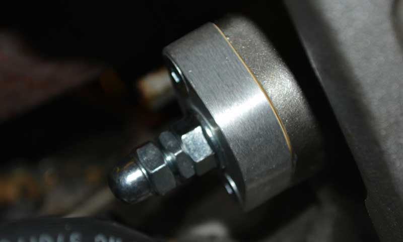

My only concern now is that I've tightened it up to tight. The CCT has been tightened to almost max. There is one turn left and there will be no more adjustment available.
Is this normal or has something else happened?

That doesn't look right. Krieger fitting instructions are based on the VTR1000 site instructions so something's gone awry.
Are you a member over at VTR1000.org as there might be someone near to you in Scotland who can pop over and steer you right.

IIRC I think Krieger may have shorted the rear tensioner even more so not so long ago. I have not seen one screwed in as far as that before but have seen them pretty close to as far as they can go.
I'm wondering whether you was on the compression stroke when you cable tied (tie wrapped) the sprockets and removed the old tensioner. This could make things jump. If it has jumped a few teeth then it's no bigge to sort out. Just don't go trying to start the engine.

I checked the timing and I was 2 teeth out on the exhaust cam and a whopping 6 teeth out on the inlet. It took one hell of a jump. Got that all sorted out now and timed in properly.
The front cylinder was a doddle.
I think I had to much slack on the chain when I thought I had finished the rear cylinder. I hadn't read the vtr1000.org guide until it was posted earlier.
Finally everything checked out with the measurements and there were no unusual noises when I turned the engine over by hand.
I think the bolt must have been shorter than usual and that's why it looks like its wound in so much.

I put my Krieger CCTs in a few weeks ago and mine looks about like that. I thought something might be wrong so I pulled it apart and put it all back together again and it's all good. The rear one is just really short for some reason.
Better than being so long that your spanner/socket keeps getting caught on the brake line or earth strap. LOL Krieger have always had one shorter but recently they have gone even more extreme with how short they can go. I like it, there's no reason for a great big thread that is not used to be sticking out so far.

It's recommended to use some threadlock on the tensioner threads to both make it is oil tight and to ensure it can't unwind. As for the leaky cam cover just apply a few small dabs of silcone on the cam cover gasket to keep it aligned when replacing the cover - no need to smother it.

mine also is very short at the rear
i thougt i put the front cct on the rear but it seems normal
ive put 2 locknuts on the thread, threadlock on the bolts
and heat proof silicone on the gasket (small amount)
and when reusing valve cover gaskets i always use alot of sealent to keep ik in place when mounting mostly and for proper seal
