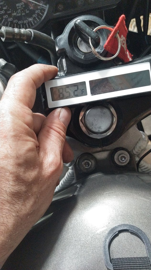

2.) I added a temperature probe to my air filter housing today and went on a long ride to see how much heat would soak in. After a half hour or so in 87 degree weather the intake temps were at about 107 degrees f. Apparently this has obvious effects on air density but it also apparently creates a boundary layer inside the air box and has a detrimental effect on flow.
So, the way I figure it is that we have two sources of heat..the engine itself that radiates heat but also the PCV system pulling hot gas from the valve cover....If you're following along we should modify the PCV system the way the CBR guys do and add a thermal coating to the air box. There are hard numbers out there that I wont go into here but for every 1 degree drop in temp there is a corresponding increase in air density and thus power.
Food for thought
AV
Before I even started the bike
After a half hour or so, engine temp at 190 ish.

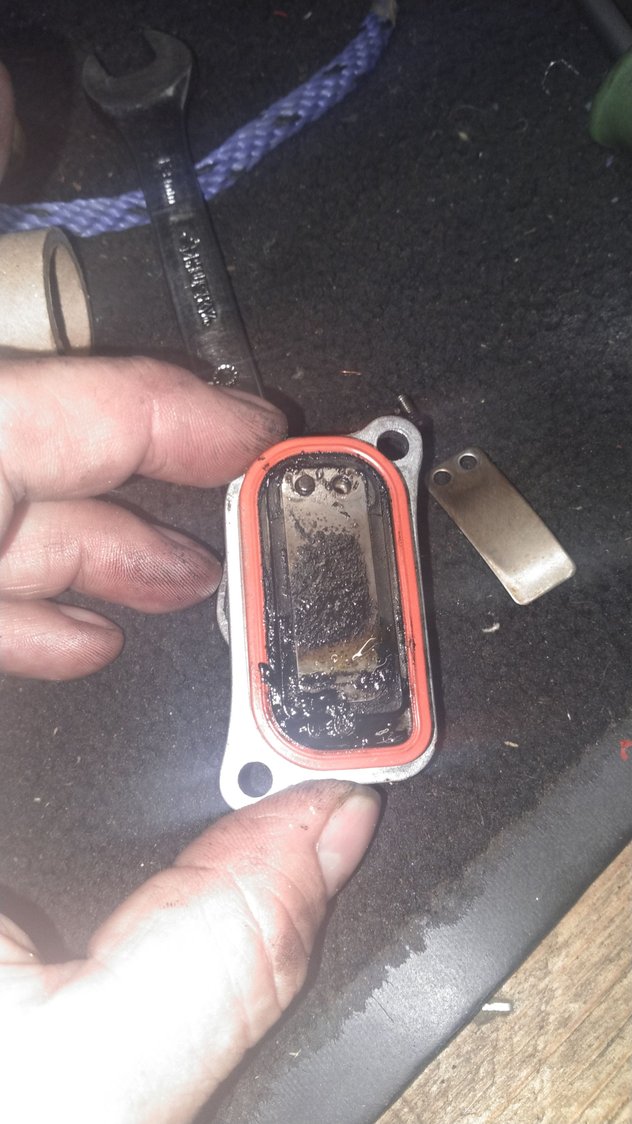

I considered a canister but did not do it for the reason illustrated in the photo. However, today I walked my talk and re routed the PCV to the PAIR. But first...it's been 1k miles on the new motor so I figured it was time for a valve adjustment and I was right. Only two were in spec and all the other were out by enough to make me cringe. Alas, the VTR had the last laugh,,,after I buttoned it up and started it she clicked and clacked like a tap dancer. Turns out doing shim calc at 530 in the morning is a bad idea, I set mine at .014" on the exhaust side instead of .012". No biggy, I re-adjusted the rear exhaust cam and voila...she is golden. On to the PCV mod...
For those unaware...
This is a dirty reed valve that has been in a bike for 1000 miles.
This is the other side
This is how to route hoses to connect PCV to PAIR.
This is what the reed valve looks like when it's as Honda intended
There are of course much neater ways to make this happen, but this the quick and dirty route to get the PCV out of the airbox and put the PAIR to good use. FWIW, my reed valve was filthy, full of crud and a little bit of condensation. That alone is enough reason for me not to have my reed valve flipped. YMMV...good luck.
