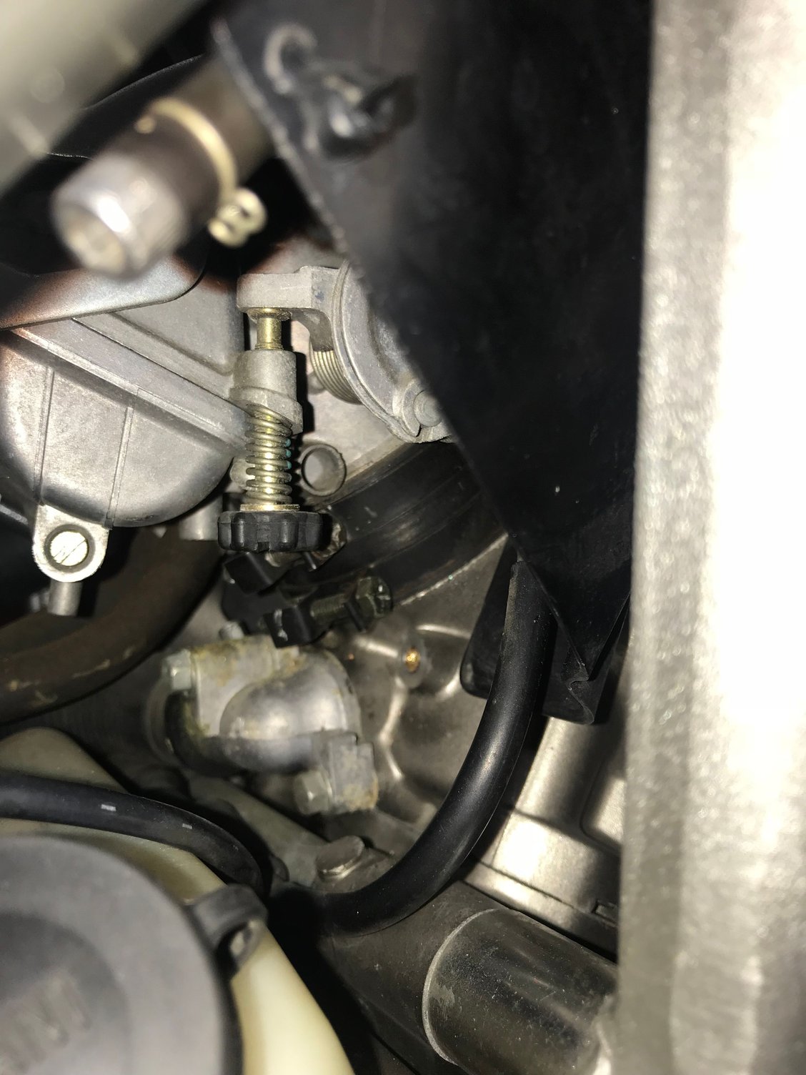

Obviously not appreciating how soft brass is relative to steel, I overtightened the brass fitting I was using to do the carb sync mod on the front cylinder and snapped it off flush with the jug. Of course, I used loctite since it was never coming out. Any suggestions?
Thoughts are to remove the carbs to access access from behind maybe to plug the rear side somehow and then use an easy out externally. Can’t believe I did this.

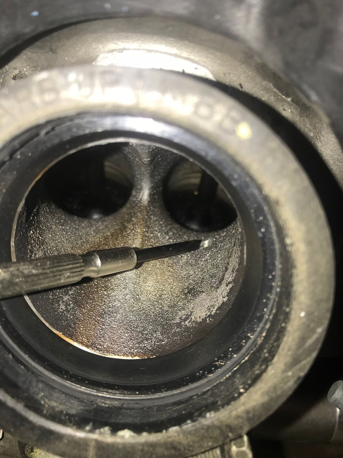

Removed the carbs to find that the threaded port is accessible from the inside. Plenty
of room on top. Feeling better now. Going to try heat and easy out as suggested.

Was able to back out the broken fitting with heat (butane) and an easy out. Retapped hole for good measure. No filings into valves. So relieved! Carb sync mod completed.
Thanks E. Marquez!!! And others for advice.
