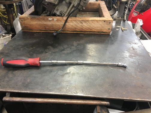

Also, what tool do you use to turn the sync screw? I have a flexable screw driver, but I keep dropping bits (will tape it tomorrow). I do not see any other way to do this.

  #65
I use a 1/4" driver handle and a Snap On 4" & 3" wobble extension with a Snap On 7mm flex socket on the end.
I have also used a 1/4" driver handle, flex extension (one of the spring types ) a 1/4" universal joint and 7mm socket. If the universal is too loose and the socket falls over, try a piece of electrical tape around the joint.
After each adjustment take the tool off the screw, and blip the throttle a few times...make sure back lash in the screw is in its running state. (NOTE with some sync tools, "blipping" the throttle may cause fluid to get sucked into the engine....If so, don't do that..lol or get a Sync tool that it cant happen with
