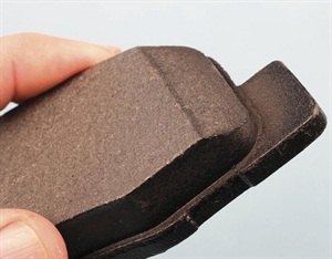

So the fix for this is to chamfer the pads in the direction of the issue. Meaning the leading edge while going backward. Remove the pads and sand them with like 110 grit paper at a 45* angle. You are trying to make a beveled edge as the rotor slides onto the pads.
Many pads come with this design. You can even just carefully use concrete to do this. Once you chamfer them this issue will stop.
Doesn't have to be this dramatic. Any bit of this type of angle will work.
