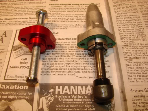

Hopefully you did not waste anything else, you will quickly find out. In any case, replace the CCTs with manual units like APEs on the left below. Stock unit on the right.
Why does it seem (visually only I am sure) like the OEM is so much nicer and the APE is basically just a big screw and nut. (sorry for the dumb q)

The epitome of eloquence is simplicity .
Because the APE is just a big screw and nut. (or rather shaped nut plus normal retaining nut)
The thing is.. the APE doesn't have fiddly little bits and a over worked, under built, improperly oiled (cooled) spring that eventually will fail and take out your valve train when it does.
If you want the constantly adjusting features of the OEM CCTs, go ahead and use them, they are usually safe for a good long while. Just swap them out every few valve check intervals, even though Honda says they never need replacing, we know better from experience.
(or just get a big dumb bolt and be done with it for good)
