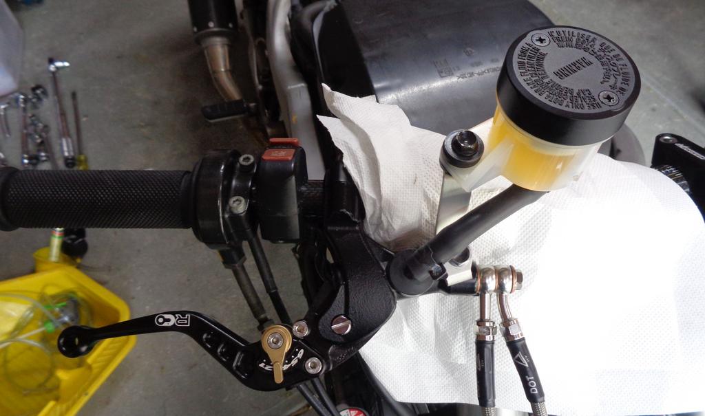

Hi,
I'm in the process of doing a front end swap,
I have a 2012 cbr1000rr forks, front wheel, brake disc's and calipers fitted,
I had a new in box 2005 vtr1000 sp2 front brake master cylinder and new Venhill braided lines,
I've bleed the master at the master banjo bolt and bleed down at the caliper bleed screw's with fluid coming out with no visible signs of any air bubbles, (also using new from a sealed container Penrite brake fluid)
problem is, the brake lever feels very soft with lots of travel !? Is the problem with the SP2 master not working with the CBR radial calipers ? or is there some other issue possibly going on ?
Any advice or help will be greatly appreciated.

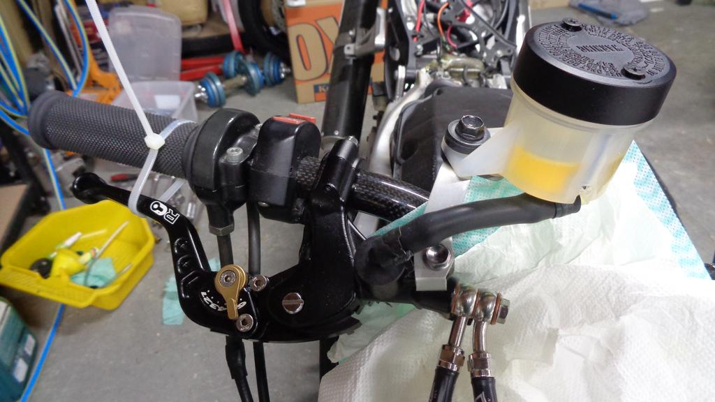

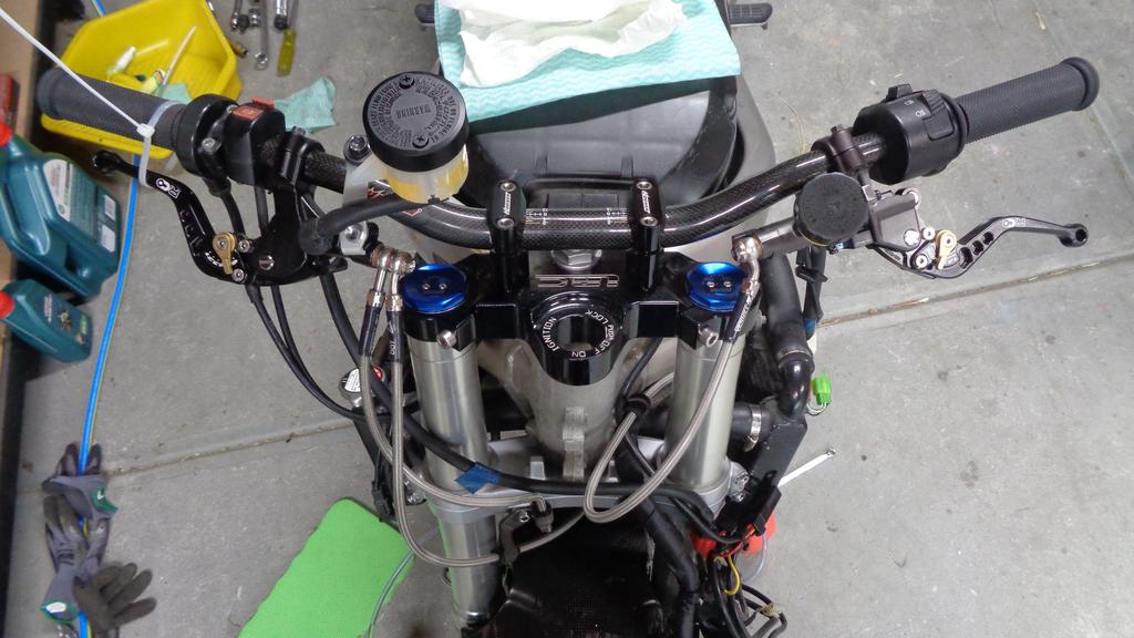

Thought I would try the ziptie the lever over night method ....
some pic's of my front end swap progress,

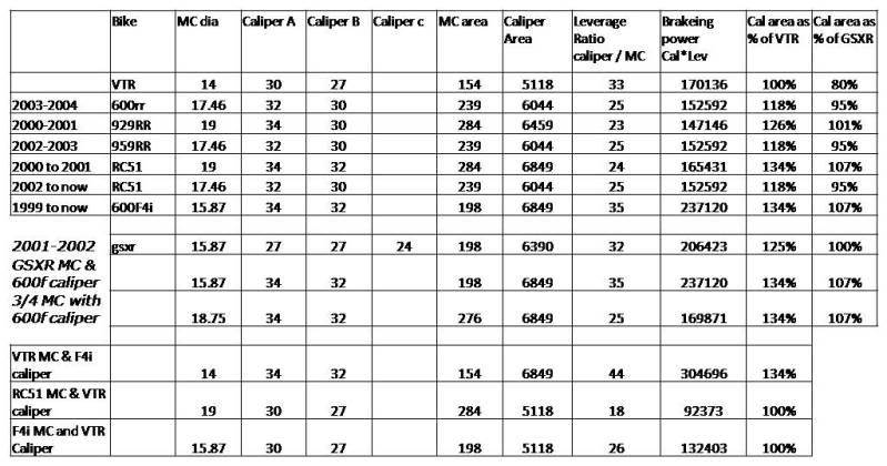

While I think the others are right about air still trapped in the system, the long pull and soft feel could be because the master slave ratio is a long way from what is considered ideal. Knowing what size the CBR calipers are and what size master was use with them would be helpful. If you look at the chart that was posted You’ll see with the 14mm SH master and the larger calipers the ratio goes way up.

I went out into the garage for another session of brake bleeding, I have placed paper towel around the master cylinder area just in case I have any spills and can hopefully minimise any brake fluid making a mess, I put a fresh piece of paper towel down this morning and when I came out after having breakfast to start some brake bleeding, I noticed a damp spot on the paper towel just under the banjo bolt coming from the master cylinder, on closer inspection it looks like the Venhill line is leaking from the swivel nut at banjo.
I gave the nut a loosen and tighten, then proceeded to do my old school bleeding technique of pumping the lever, crack open the caliper bleed screw, close bleed screw, release lever and repeat. In a few minutes I had a nice firm lever with less travel !
Cool, I now have a good feeling brake lever and am happy with the bleeding process and now have confirmation that the SP2 brake master cylinder will work and is compatible with the 2012 CBR1000RR radial calipers.
But unfortunately the Venhill line is still leaking from the swivel nut at the master banjo, I took a look at the Venhill website and they say to hand snug up the swivel nut and if leaking, loosen and snug up again. I guess for now at least I sorted the main issue and have a firm brake lever, but I now need to keep an eye on the leak and possibly order a new replacement line !?
