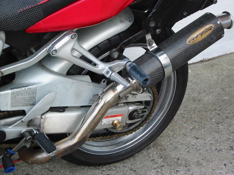

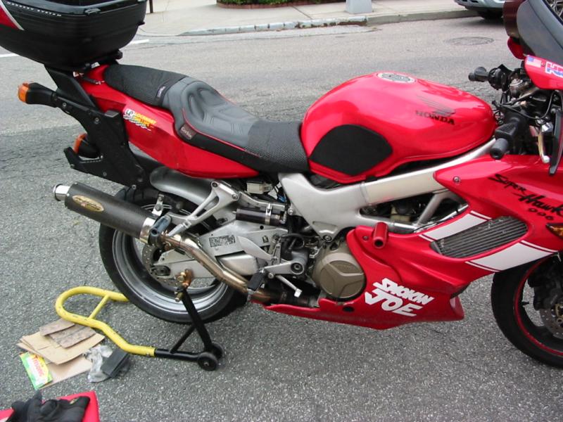

Hey man remember this post from Smokinjoe?? These are cheap and work:
Honda CBR crash protectors
Old Dec 11, 2012 | 09:44 AM
These have kept my carbon two bros cans alive for 10yrs.
They began life as delrin rod from mcmaster-carr.com and were lathed but really any t-rex sliders will work if they have flat mounting surfaces(some are not). I used red t-rex in the front to color match.
Attached Thumbnails Getting Frame Sliders-rim-polish-006.jpg   Getting Frame Sliders-wheels-006.jpg
