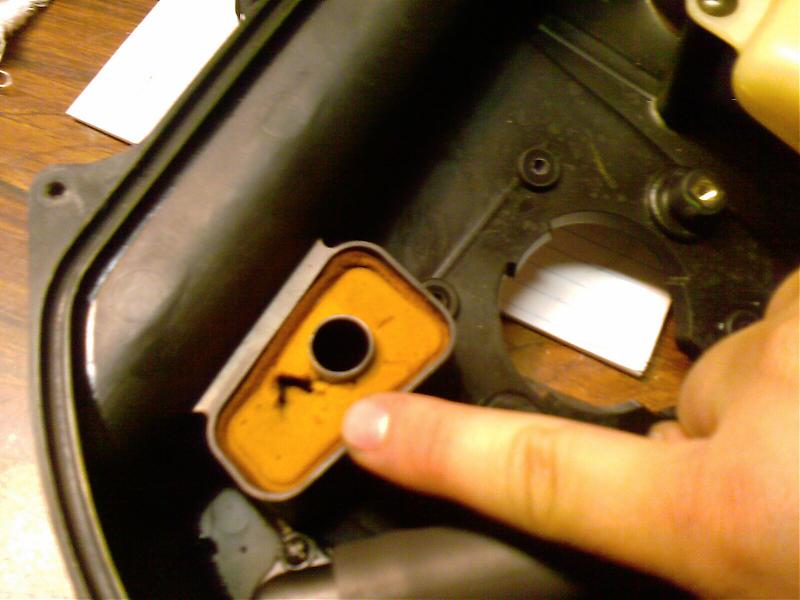

Old Apr 9, 2008 | 08:25 PM
speedhawk's Avatar
One Wheel Wonder
Joined: Apr 2007
Posts: 60
From: Dallas(rockwall), TX.
speedhawk is on a distinguished road
here is the foam peice in the air box i am talking about.
Old Apr 9, 2008 | 09:03 PM
I believe those foam things filter the incoming air into the carburetor "air vent tubes" I'm not 100% sure what the air vent tubes do but I think they go to the top side of the diaphragm.
Part number is: 17254-MBB-000
Description FILTER, SUB A/CLNR
Price $1.55
Information is from RonAyers
