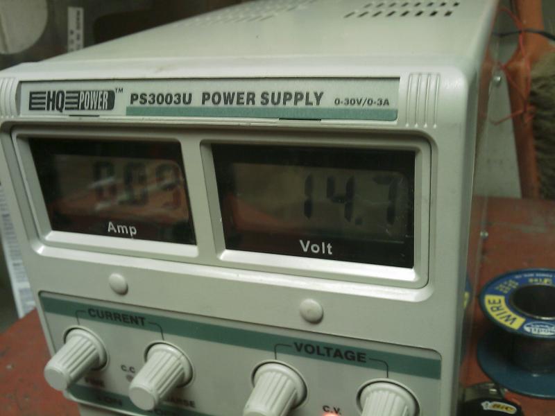

Its the R/R regulating the voltage wrong.
Its still charging the battery, but the level had to be within 1 volt of nominal for that picky winker relay to function right.
Im not saying get a new R/R, or that yours is "bad", as yours will probably keep charging for some time.
But on the one I build, theres an adjustment pot, and I noticed that until its adjusted right to the exact spot the winker relay likes, you will get the weird behavior like you describe, even on my own bikes. I think its just a flaky circuit for the winkers. Other bikes winker circuits are not sensitive like the superhawks.
One way you can experiment, is put a battery charger on the battery, and watch the voltage. Try the winker at several voltages, and you will notice it works better at certain voltages than others.
From what I can tell. it likes the 15 - 15.5 volts nominal charge level

It's a combination of being both voltage dependent and temperature dependent. I haven't heard an explanation that makes sense for both.
It works instantly on a cold bike that's shut off. It works instantly on bike that's been running for 30 seconds. It's only that part in between where it doesn't go.

Right about .... here.
And my winker happily winks the instant its commanded to wink.
And...I beleive...it varies from hawk to hawk! bah! lol
