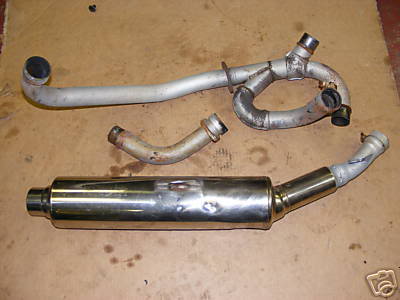

Old May 11, 2008 | 05:26 PM
Springbubba's Avatar
Uhhhhh..huh.huh..Member..
Joined: Apr 2008
Posts: 269
From: Vancouver, WA
I bought a used exhaust, with one dented/scratched can on Ebay for $58 with shipping a week ago. It was the second one I have seen on there in the last couple weeks. Might be an option if you want to get a used pipe.
