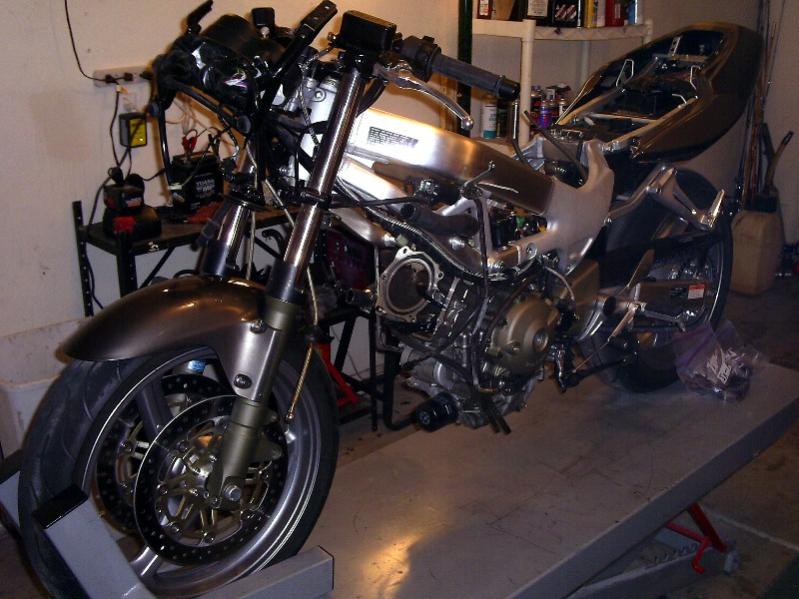

Engine have to removed for head gaskets??
Looks like it may be tight but can it be done?
Old Jun 6, 2009 | 07:09 PM
Yes, easily done.
Attached Thumbnails Engine have to removed for head gaskets??-vtr1000f5-007.jpg
Old Jun 7, 2009 | 12:11 AM
Circuit_Burner's Avatar
guru of things sparky
Posts: 599
From: Grand Prairie , Texas
Yea, but why?
Its so easy to lift the bike off the motor and swingarm.
Its like a half-bike, lol.
