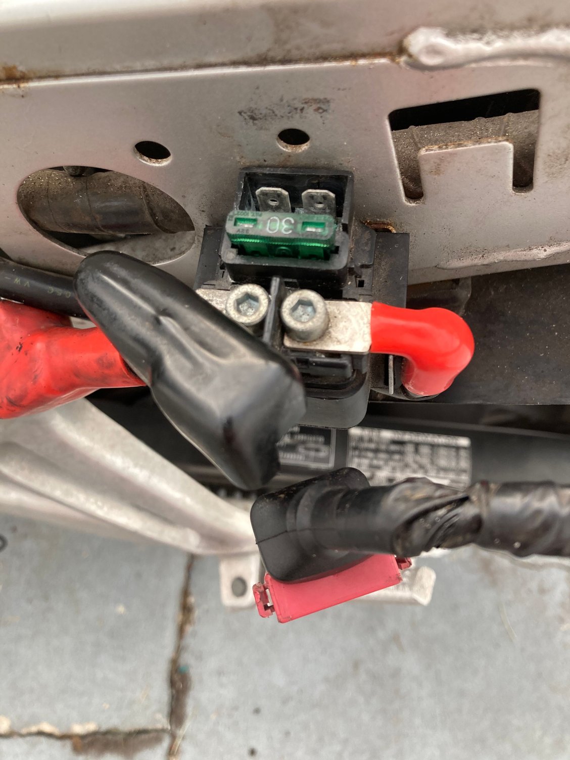

I have little experience working on motorcycles just to start off, especially electrical parts and wiring. But I have a 98 SH I recently bought and was putting a plug in LED headlight bulb in to try to have a better view at night.. it didn’t work after plugging in so I just tried putting the old bulb back in, that didn’t work either. Now the bike won’t start but all the other lights and everything work and all the fuses are good including the main. Any suggestions on what to check? I’m sure it’s something easy that I just don’t know about

I decided to double check the main fuse with the test light. Its fine and there’s power coming from the battery, but no power to the right post that goes to the starter?

Replace the starter relay,it's what your cables and fuse are attached to. Mine left me stranded years ago.Using your voltmeter you will see 12+ volts on the left side of the relay{feed from battery} on the right you should see the same voltage when you push the starter button {Cable feed to starter}. If you don't see voltage,the relay has failed.
The same relay was used on many Honda's,I bought mine on Ebay cheap.
