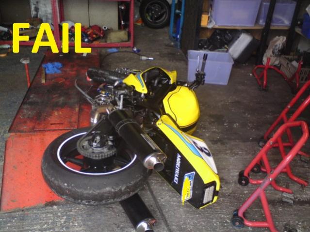

after 5 years of bikes up and down everyday i ran at the ramp with the stand down on my own freshly painted bike (sure if you didnt laugh youd cry )
and im in bed now after busting my back picking it up as i more or less only can use one shoulder
doh!! hehe
