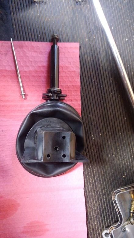

Alright, so after the dyno run I decided to do a little digging. Turning in the AF screws helped but I'm sure they alone will not get me from 10.8 to 14.ish. I pulled the carbs and what I found are adjustable needles of an unknown source, and 190 main in the front, 195 in the rear with oem pilots. The needles were 1 from bottom with 2 shims on top (odd.) So, that explains why it was rich all over, huge mains and lifted needles. Also the slides were drilled. IIRC the slide drilling is DJ thing right? So it seems likely the needles and mains are DJ? Any thoughts?
Thanks
Old Aug 20, 2018 | 05:09 AM
Calibrated eyeball testing via laptop screen.... Ya they look like a set of DJ needles I have
Add in, Yes, drilling the slide in that location is a DJ thing and I think your on the right track.
The Jets, were they marked Keihin ? If not Keihin marked, Id say then its a sure bet on the DJ kit in there

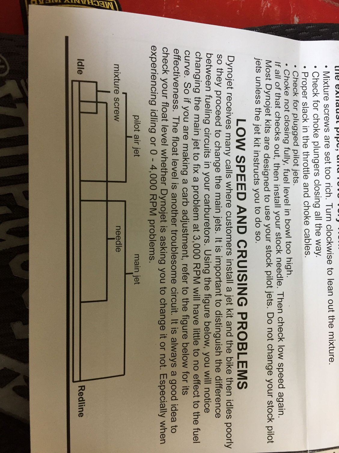

Fuel screws are for the lowest part of the circuit.
Here is a chart that comes with the Dynojet kits.

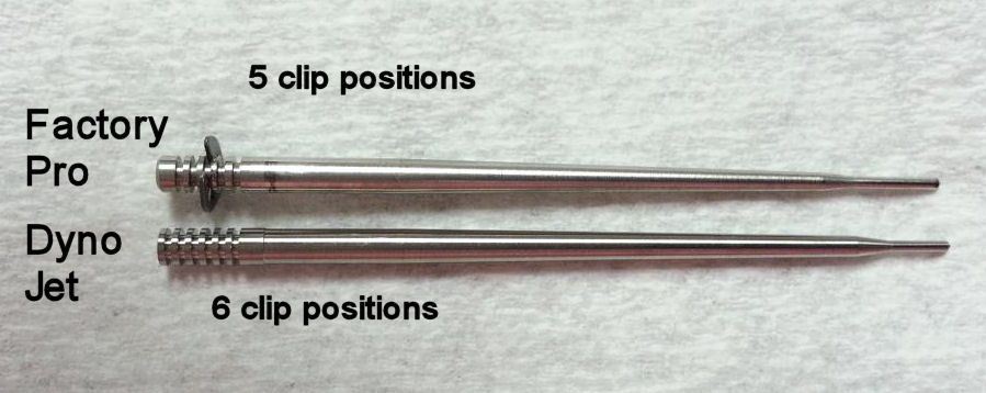

Someone correct me if I'm wrong, but I believe the Factory Pro needles had 5 grooves and the Dynojet needles had 6 grooves.
Old Aug 20, 2018 | 10:26 AM

Confirmed...they are DJ's. So, I logged on to jets r us and ordered 180/185 as per the DJ instructions along with a fresh set of plugs. A little more cleaning and I think it'll be just fine. I found that the pilot jet was also clogged. after a bit of soaking all is well. I think I'll get to work buttoning things up tomorrow.

AS said ditch the carb heater plumbing.. i also had to block the third lift hole in my carbs to get it running properly. it was always a little fluffy so i suspected it was running rich when i opened the throttle. blocked the extra lift hole and it cured my problem..

Ditched indeed. Much nicer now. I think I may look into the third hole fixing, I am somewhat suspicious of that concept.

not storm related but, i also have a FMX650 supermoto. was running like a pig and was fitted with a K&N filter and dyno jet kit, again i blocked the third lift hole and boom, away it went. sorted.

For sure, I filled mine yesterday, I lost no performance whatsoever on the butt dyno and it most definitely throttles better.
