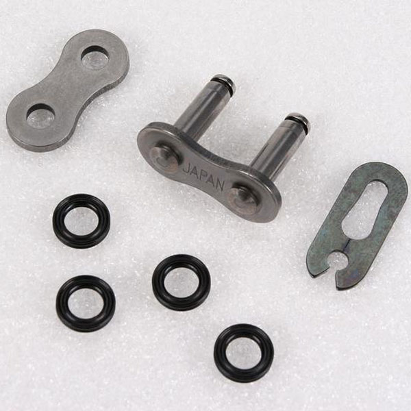

Regarding clip links, I'v been riding for 20 years, i worked as a motorcycle messanger for 5 years working monday-friday, 7am-7pm (12 hour days) averaging 100,000 k's a year & always used clip link's on my Regina gold chains, never had a problem.
Attached Thumbnails DIY Chain replacement....?-0000_ek_clip_connecting_link_for_520_srx_chain.jpg
