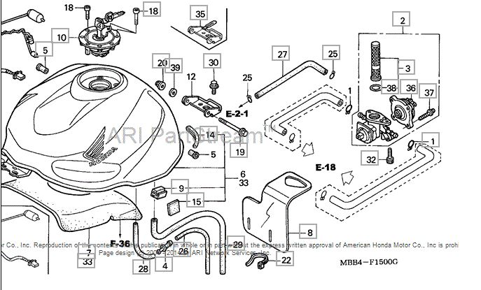

The bike doesn't have a fuel filter stock. There is some threads on here on how to retro fit them
while there isn't a fuel filter in the fuel lines, there is a fine screen in the tank fitted to the petcock. Part #3. Maybe there is debris causing poor fuel delivery.
