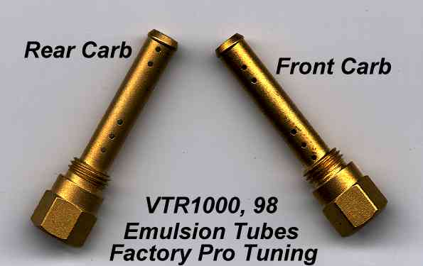

Well you had the carbs out did you also pulll & clean the emulsion tubes?
And if so did you keep them separated as they are different for each carb.
Attachment 11785
Service manual calls that the "Needle jet holder?" I had the carbs dissassembled down to everything I could take out of them. I left the jets in the "needle jet holder," but had the holder out for cleaning and inspection. When I had them out, after soaking in MEK, I ran a piece of wire through everything to make sure I had everything out of the jets, then flushed with MEK and then carb cleaner, then compresed air. I didn't think it necessary to take the jets out, just a good cleaning and inspection. I also dissassembled/re-assembled one at a time because I didn't want to mix/match parts. I didn't put anything but MEK/crab cleaner/air in the carb itself.
I am taking my son and wife to the Strawberry Festival in a few minutes. But when I get home, I'm going to take the carbs back off, check everything again, and put them back on. I am also going to drain the tank and remove the sender and petcock and inspect that stuff as well. I have a feeling I am having a flow issue. The bike started up and ran fine after reciveing my ticket for doing 67 in a 50. Good thing he didn't see me a mile earlier ir I might have gone to jail! Thats the reason why it's going to become a track bike. More later. Walking out the door for the festival.
Needle jet holder, emulsion tube...... one in the same.
You might want to separate the jet from the holder to make sure there is no gunk in there.
Also I would be real careful with the wire through the holes. The emulsion tube brass is pretty soft and the hole size is critical. That is why I just blow them out with air after the cleaner. If I can't get them clean that way, I just replace them.
