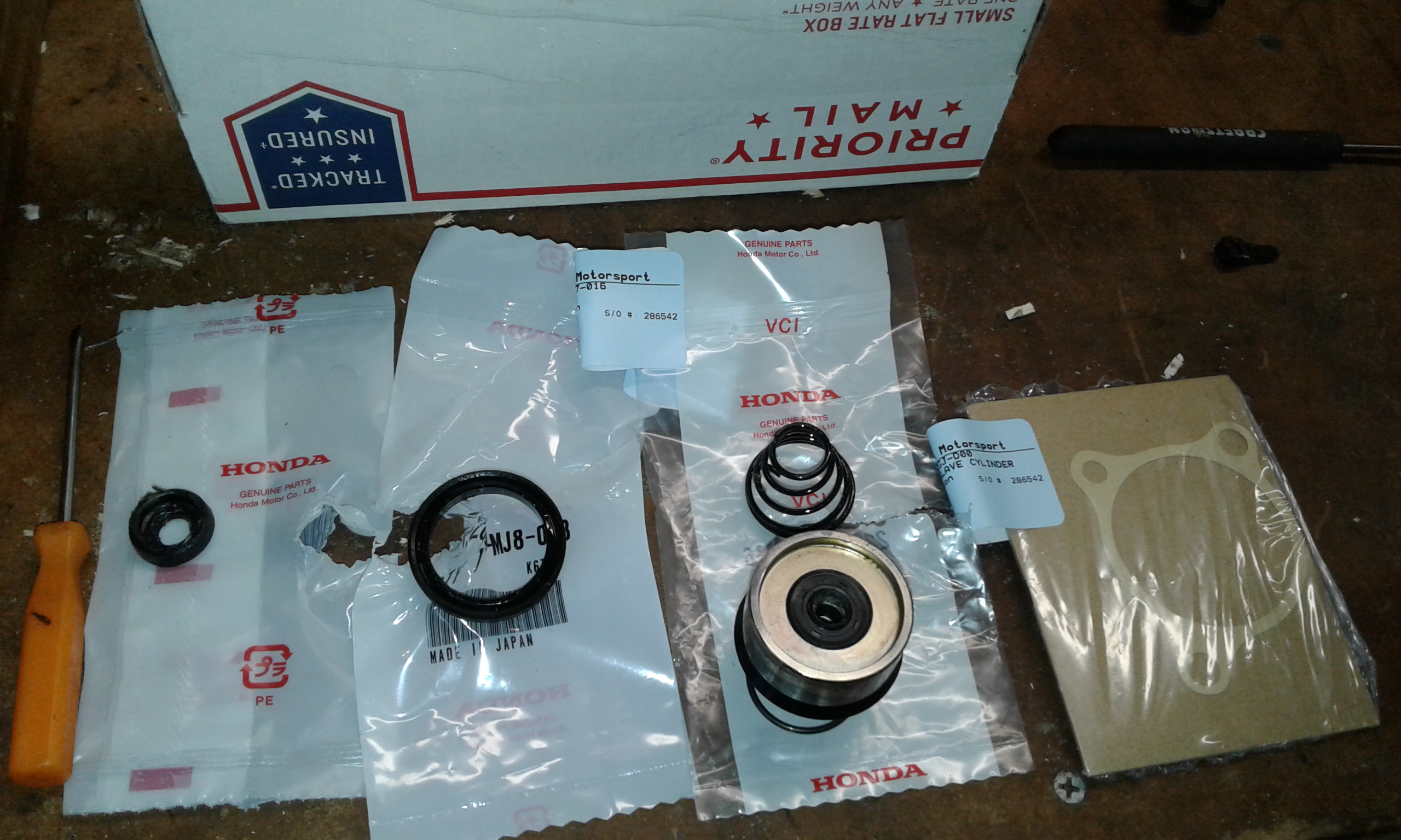

Here is the thread with the part numbers. Parts were cheap enough that I just replaced them all with OEM. Master kit was a made in Japan K&L.

Is it a drive out press in deal? Any special tools?
Old Apr 19, 2017 | 05:45 PM
Posts: 5,221
Zero special tools. Just replace rubber seals, nothing special needed.

Cool man thanks, ordered mine.

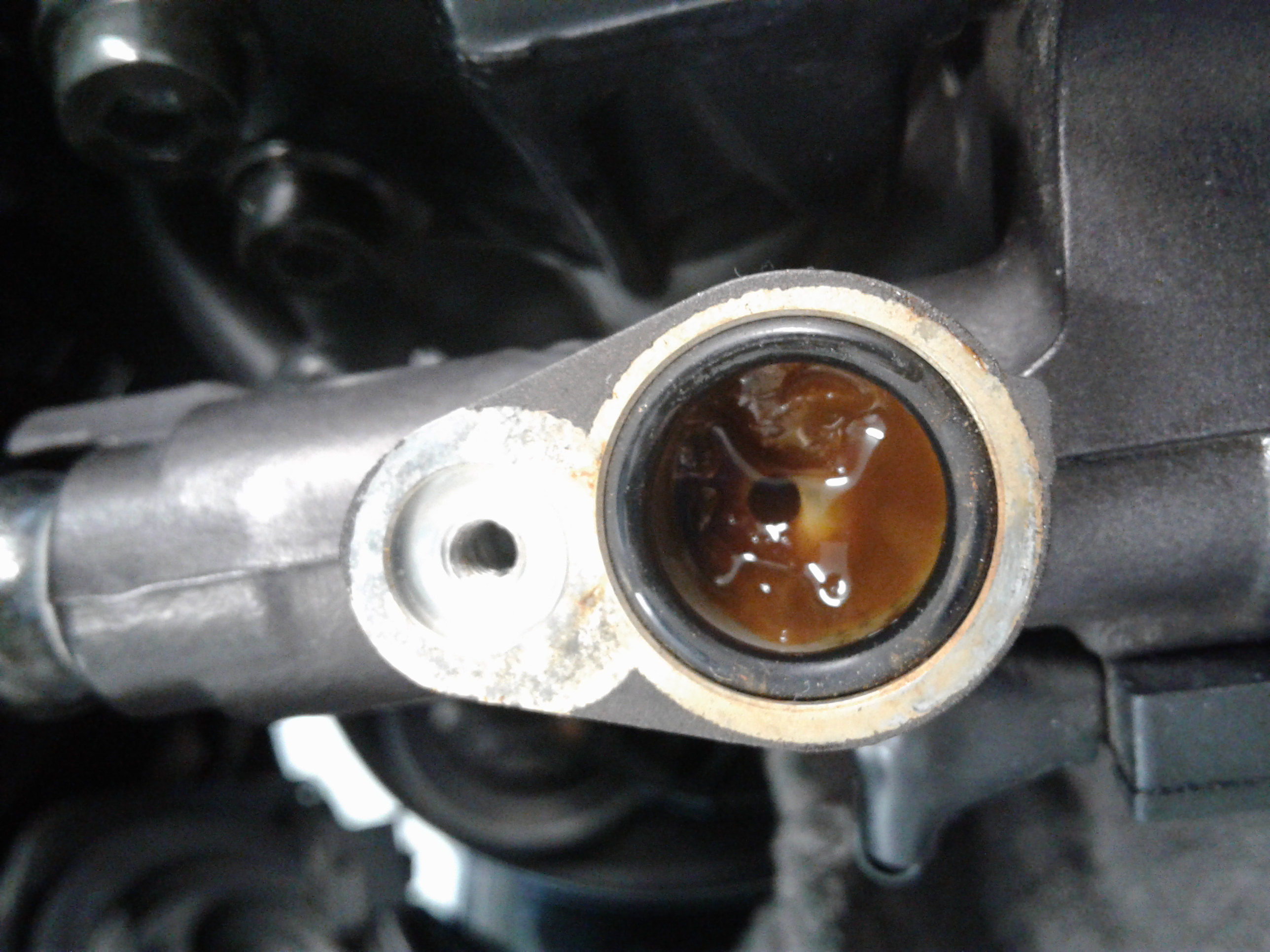

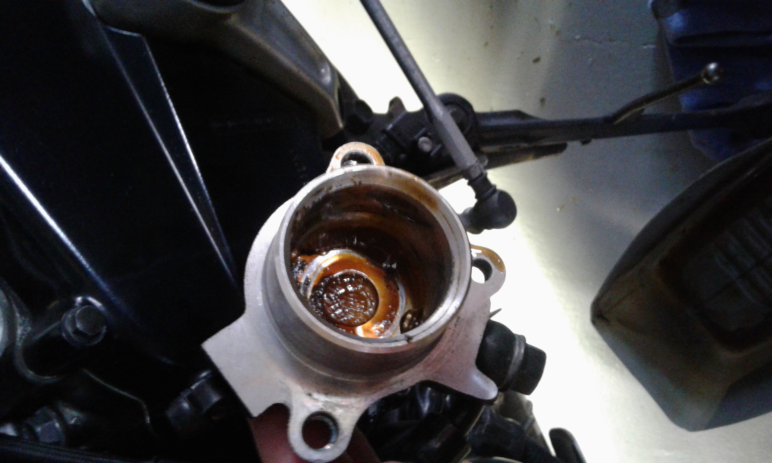

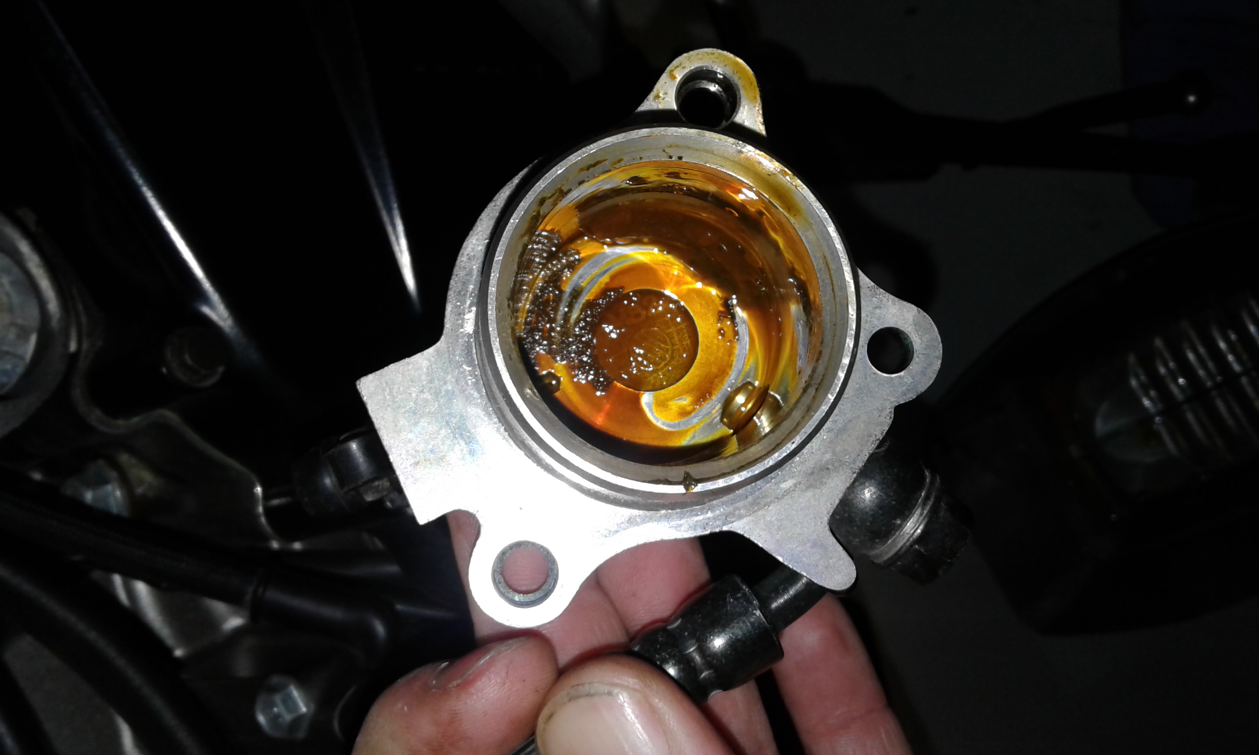

Posts: 5,221
Your fluid is probably in there mixing it up with gunk. Mine was horrid. I was a bit ashamed it got that bad.

Haha, ok so that was for sure the nastiest part on the whole bike. Totally caked with crud. Scrubbed it, honed it with 400 grit, installed the rebuild kit. Quick bleed and hopefully its ok.

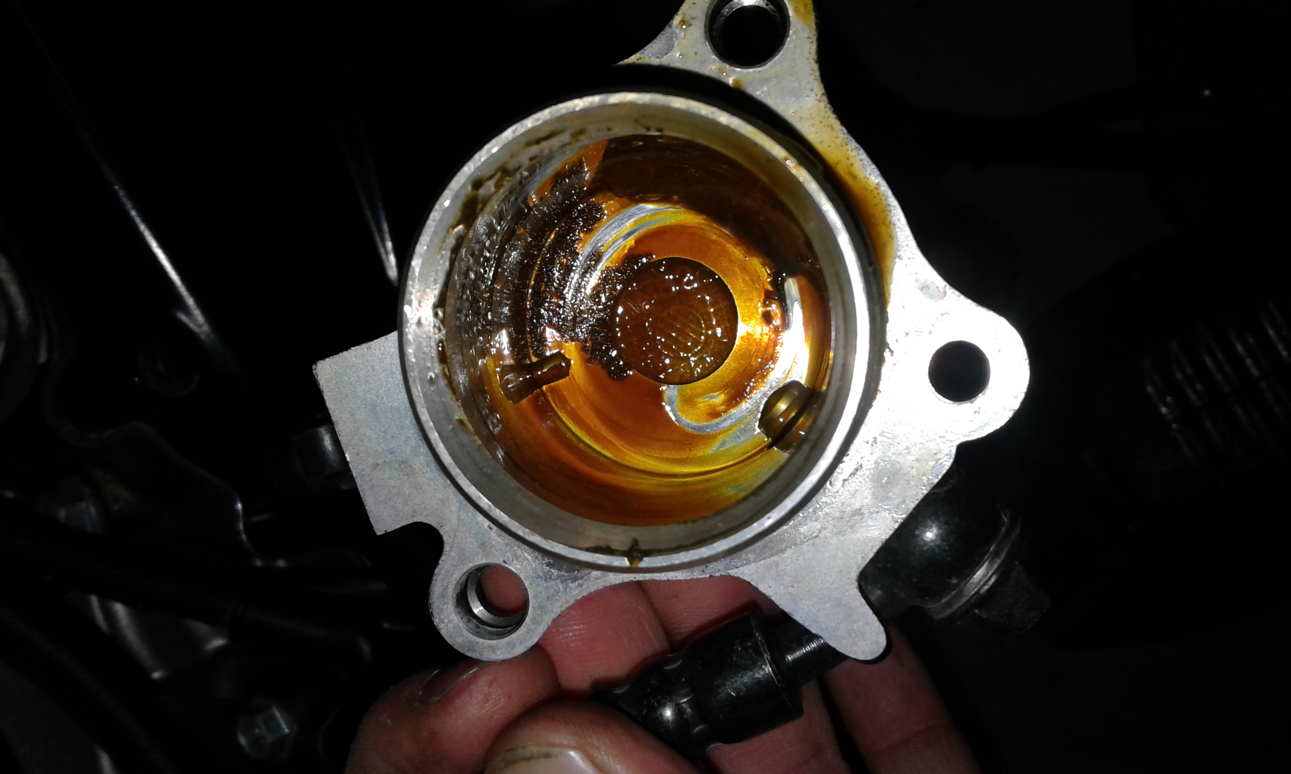

Should be ok unless you push some of that crud down from the master.
This was a cbr1k I refurb'd a few weeks ago. Mine wasn't near this bad but it did have a little in there.

But that's the master right? I should look at that too but I am good about changing and flushing fluid. The slave was worse than anything you pictured above. Glad its done.

It is, yes. But if your slave was that bad, chances are the master has some goop too. I'm pretty good with fluid changes as well, but it happens...
I really didn't need a kit, a good thorough cleaning would have sufficed but I figured while I was in there, might as well.
