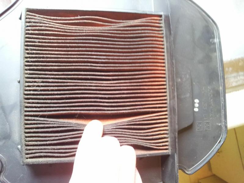

Checked my air filter for the first time today... is this right? (pic)
Old Jun 28, 2013 | 09:41 AM
sorny's Avatar
Joined: Jun 2013
Posts: 77
From: Oneida, TN (East TN)
sorny is on a distinguished road
I got my SH a few weeks ago and finally got around to checking the air filter. When I saw that the element was red I thought it was a K&N at first but then saw the "Honda PP-MD30" on it. I assume that's a stock filter right? Either way it's pretty nasty. Really black and grimey on the tips of the paper and when you pull it open its ok in some spots but there's big hunks of bugs and leaves and dirt/grime. What kinda worried me was that there was a little puddle of oil in the box. Maybe like less than a thimble full. Wasn't sure if that was just part of a PCV system doing its job or if ANY oil is a problem.
Here's pics attached
Attached Thumbnails Checked my air filter for the first time today... is this right? (pic)-airfilter1.jpg   Checked my air filter for the first time today... is this right? (pic)-airfilter2.jpg
Old Jun 28, 2013 | 09:45 AM
Looks like an OEM one to me

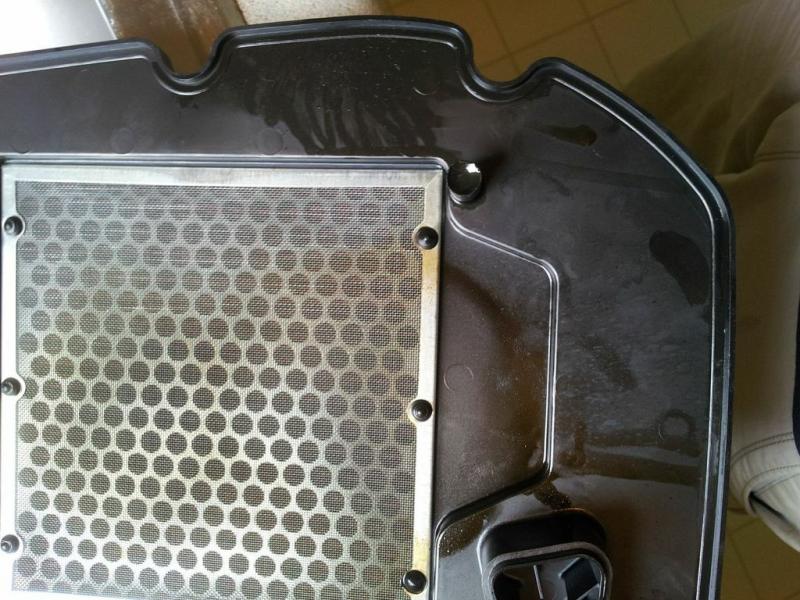

On the back side pic you can see a weird splatter mark on it, that's oil.. so i guess that's where it's coming from.
The filter looks pretty nasty right? Like i need to go ahead and order one I guess?
Old Jun 28, 2013 | 09:52 AM
RCVTR's Avatar
Joined: Dec 2005
Posts: 1,689
Looks like normal stuff. The filter is dirty. That's why you have a filter.
Oil in the airbox is due to crankcase ventilation, as you surmised.
Put a new filter in it and go ride!

Your filter doesn't look that bad. I'd say "run it". Put a new one in, when you get a chance.
