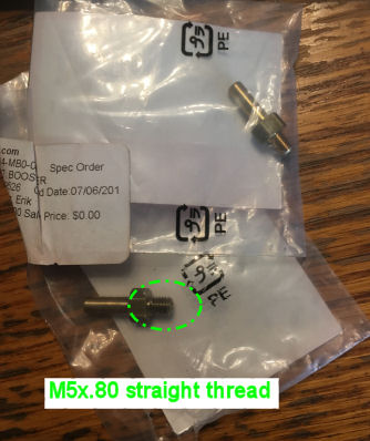

Its a simple M5x .8 straight thread so, you could drill a hole thought a M5x.80 thread screw run a nut and washer part way up, use some Teflon tape to seal it temporally for sycn
But I tell ya, getting the blanking plug out and the vacuum joint in is a pain in the *** unless you strip off body, tank and carbs....I would not do it twice...
for the price of shipping and a cup O Joe I'll send you one USPS, but doubt it will be there by this weekend.

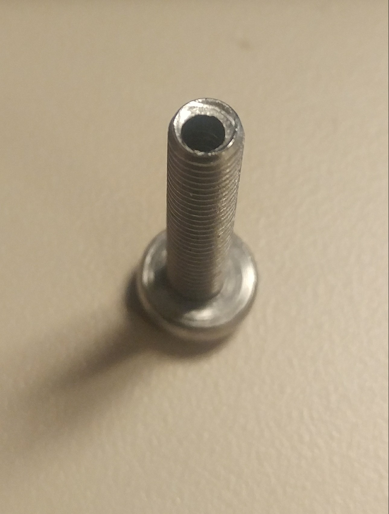

Definitely like the idea of drilling out a screw. Went ahead and did that with a drill press I got at work. A few broken bits later and I was successful with my ghetto vacuum nipple .Now I'm able to get that done tonight. Also already got the carbs out haha, have had to take em out about a dozen times now and have gotten pretty quick at it. Thanks for the idea and the offer
