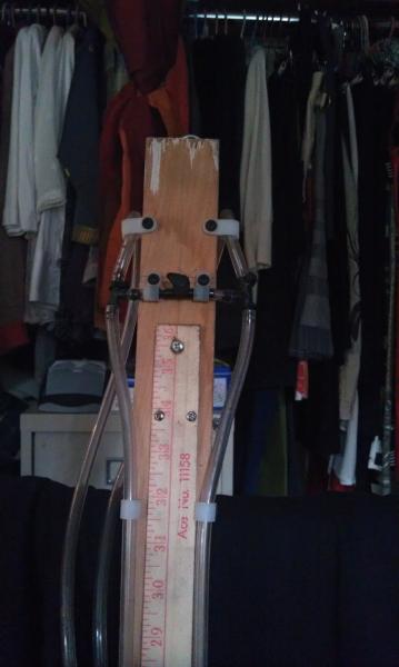

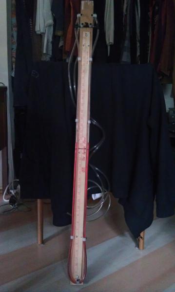

this is how I installed a valve. Turn it open and the vacuum is low, close it to increase the vacuum and increase sensitivity.
Attached Thumbnails Carb Sync Going Wrong - Fluid keeps sucking into bike-imag0292.jpg   Carb Sync Going Wrong - Fluid keeps sucking into bike-imag0293.jpg

the little valve was installed as a sensitivity adjustment/damper. I hang mine from above the bike, just next to it. I've only had fluid race to one side once, on a bike that was way out of balance because new carburetors were installed. I use ATF in my manometer because it's easy to see. This cheap tool has been very accurate and easy to use.
THANK YOU!
This is exactly what I had in mind.
I made one that functions exactly as yours does. Worked like a charm, movement is moderate enough at the beginning I had no problem managing the adjustment without sucking any 2 stroke oil into either cylinder. Thanks for sharing that pic.
Bike idles much smoother since synch.
