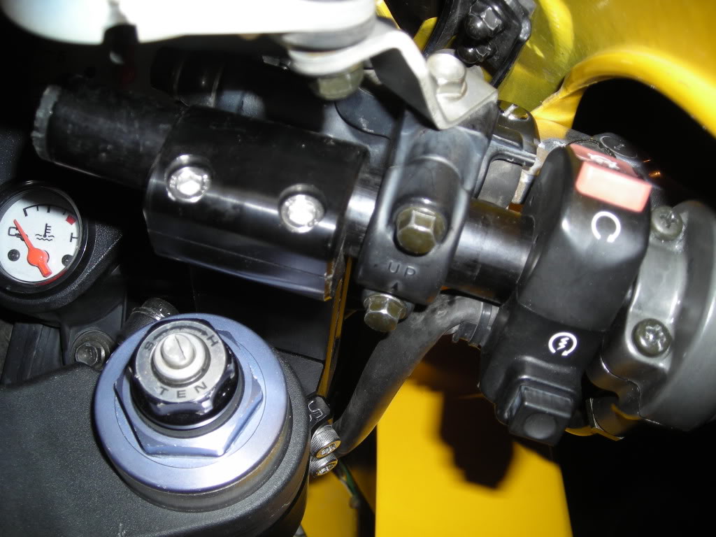

not sure which Swatt's you got, but mine with the 3.5" (maybe 3", don't remember) risers won't let that integral reservoir fit onto the bar, it's too fat where the bar meets the riser plate. I can take a picture later if you need.
Ah, so the res hits the riser.. I will look (and I also have the 3.5") to see if that seems like a likely issue.

Syclone, do you have a picture of how much interference there is between the riser and the reservoir?

I don't, I'll try to get one tomorrow. I had thought about flipping the supports around so the fat part faced back towards the rider, but they countersunk the bolt holes, so I'd probably need longer bolts, and I wasn't sure if that was a very good solution.
Hmm, I wonder if they changed the design since yours were made.. That or you got them swapped left to right or something. Because the fat part does face me.

great, I got screwed, mine face forward...
I just checked the website, and the pics all show it the other way around like yours.. I much prefer how mine are though
