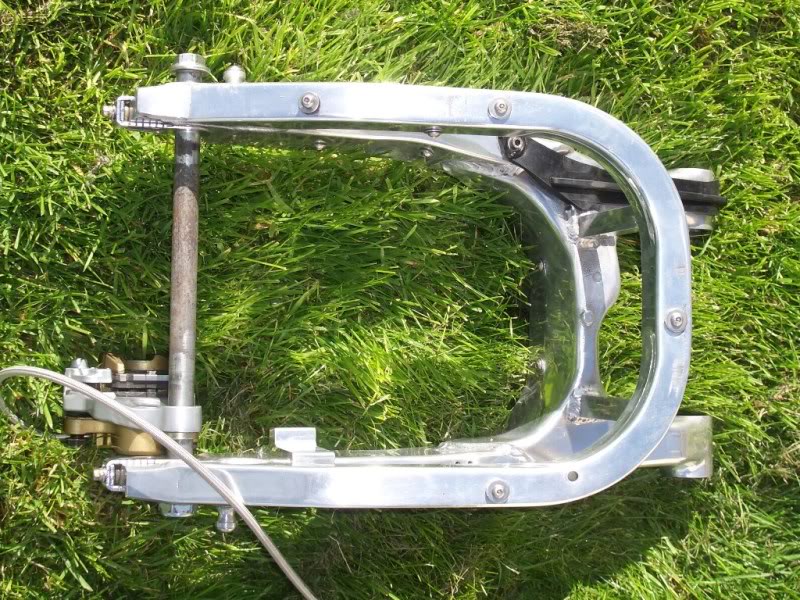

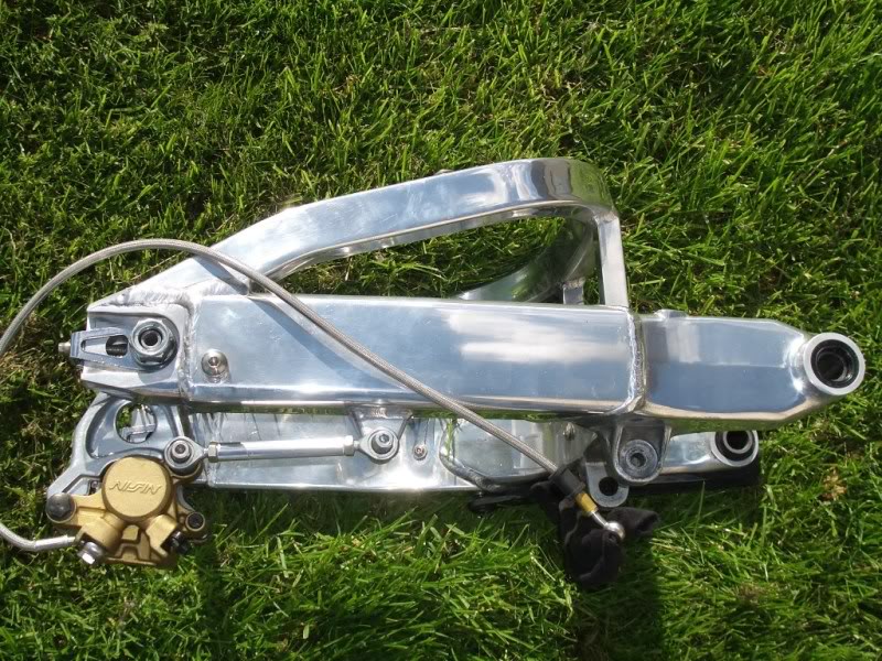

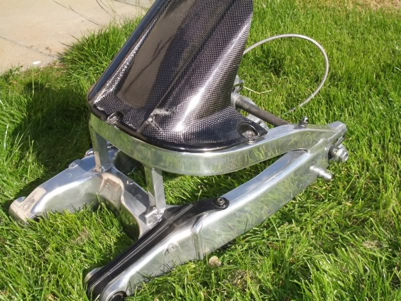

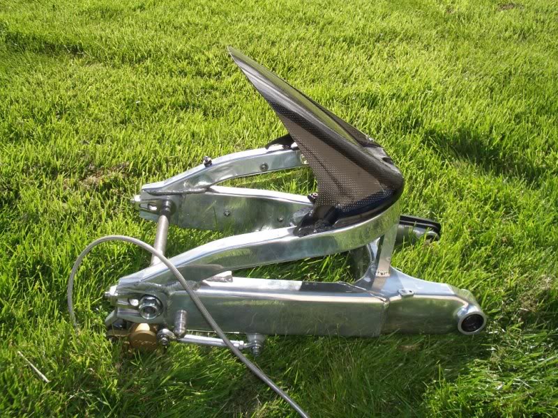

Have a look at this one. The guy used an early R1 brace and under slung the caliper looks really good. I am in the middle of doing one using the 900rr brace.

Old Dec 4, 2008 | 04:52 AM
hawxter996's Avatar
ole dirty bastard
Posts: 976
From: my house
very nicely done!
Old Dec 4, 2008 | 05:46 AM
Very nice job. Not sure what the advantage is with the caliper relocation though other than the bling factor. The final piece of the puzzle would be to powdercoat it black, mmmmmmmmmmmmmmmmmmmmm

Old Dec 4, 2008 | 07:55 AM
Well apart from the almighty bling factor the ony real reason would be that the brace is in the way of the caliper mount, so the VTR bracket won't fit, and likely the brace from the donor R1 didn't either...
When you use the 900RR brace it's usually possible to use that bracket... I think atleast?
I'll never find out at this rate as I by pure accident (yeah right!) bougth a swingarm from an 929 instead... So I'm going to attempt to force those two parts to co-exist instead... I think I need loads of therapy... altough my shrinks say it's ok with theraputic work, like knitting... So I guess I'm alright...

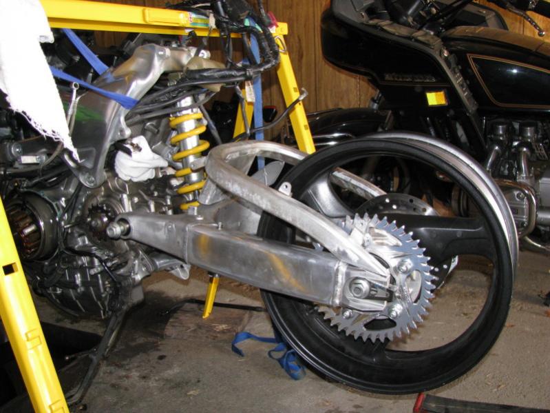

Got my swingarm done.Welded a 900rr brace on and modified the tab to accept a 900rr caliper mount.Pic is a mock up before welding.Will post some completed pics when I get home....(stuck in NJ right now...no freight!)

Old Apr 1, 2009 | 07:31 AM
Yep, looks just like mine before I had it welded. I have since had it powdercoated and am just waiting on getting it on the bike. Looking forward to it
Old Apr 1, 2009 | 07:32 AM
Nice job!
Old Apr 1, 2009 | 07:38 AM
steve.g's Avatar
Posts: 347
From: S.Dak USA
What did you do for caliper mount? I cut off the original channel inside the swingarm (for the SHK caliper mount plate) and welded on the channel from the 900rr swingarm and used that mount plate. The caliper now sits high enough to clear the brace and looks cool.Also had to change the brake line,used a custom HEL 2" longer than stock.
Old Apr 1, 2009 | 07:45 AM
I also cut the old channel and had the one from the 900RR arm welded in its place (also picked up a 900RR caliper bracket). I had not had everything assembled yet but it seems this is the standard procedure used by those who have added the brace.
Old Apr 1, 2009 | 07:50 AM
steve.g's Avatar
Posts: 347
From: S.Dak USA
Did exactly the same....Everything fitted fine... Will post completed pics when I get home
