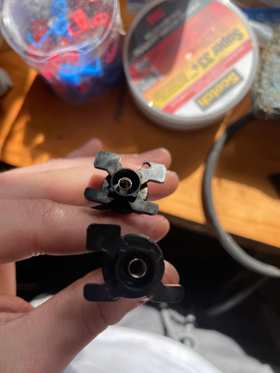

could the piece that holds the needle in cause this issue? I noticed on mine it was broken where the hole is

i checked the line, i have also checked the petcock, everything is in working order, i ran the engine with the fuel cap open and no noticeable difference, i think i have the issue found but i do not know if it is my issue, the needle holders for the slides have a little hole in them to function, the one on the rear carburetor was broken off i have photos, could this be my issue

The hole is probably the result of someone drilling the "lift " hole in the slide to install a jet kit, i.e.; Dynojet ,Etc. As long as the retainer holds the needle in place, it shouldn't be a problem. What needles are you running?

Stock pilot jets and bike came with 180 front and 185 rear main jets, the needle clip is set at 2 above the last slot, could this issue be from the TPS sensor?
