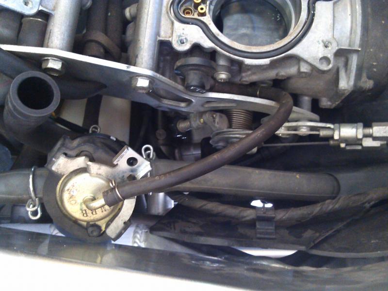

Pictured is the correct location of said hose right? my mystery hose is actually located between the piece of plastic and the frame towards the bottom right of this photo. It comes to a T by the right radiator and empties out under the oil filter on the bottom of the bike. I cant tell where the other side of the T is going other than its in between the two cylinders under the carbs. I lose it from there and cant tell where its going. I believe it to be plugged up to the coolant overflow though.
I synced the carbs (they were 5psi apart from each other) and it ran out of fuel but seemed to be acting a little nicer. I'm unsure at this point if I should go ahead while its apart and put the cams 180* from where they are now to check that or if I should reassemble and test first.

That hose is nothing to do with what Honda have done as far as I'm aware. It looks like the remains of a front cylinder vacuum take off for a Scotoiler (chain oiler) or something. Make sure it not still connected to the vacuum because if it is and the end outlet is not capped off it could cause issues.
I wouldn't jump straight into the deep end and change the timing just yet. Like I have said all the syptoms you have described so far don't suggst it to be 180 out. And if like you say the rear was set to TDC on the compression stroke before being removed and the crank has not been moved. The head gets put back on and cams put back in correctly ie lobes as they where, pointing upwards and inwards, then the timing should be the same.
But it's your bike and you have to use your own judgement as you know the symptoms and how it's behaving etc. Use that along with the advice and help from the forum. Unfortunately we can't test ride or hear your bike for ourselves so all we have to go on is from what you describe. Like I said earlier it wont do any harm to try it, so if you want to rule out the 180 then do so. But it very well could be a waste of time apart from elimination.

Alright Carl I'm confused, are you saying the hose that I have hooked up to that brass colored piece is wrong? or are you talking about the hose you cant really see in the picture? I have tested the other hose and it does not have any vacuum to it, however the hose plugged into the little dohickey does
I didn't know you had anything on there. I have my front vacuum take off on there for my carb sync.
From Honda the front is blanked off. Most VTR owners will remove the cap and fit a hose for a front vaccum take off for syncing carbs. I'm talking about the one in the pic. It may have previously at some point been attached to the front vacuum take off for something else like a Scottoiler or something so most likely redundant now and just leftovers from the previous owner to confuse the new owner LOL The T peice is a bit of a give away as well because they are often used to tap into a vacuum hose if it's in use already.
I think you have some left over remains of something where someone has had accessories. So you could most likely remove all those hoses/t-pieces we can't account for.
Do you have the front vacuum take off for carb sync in the brass nipple then. If you have make sure the other end is capped off.

Just had another thought. That little hose on the bottom right of the pic looks like it goes into the loom. It's not an alarm wire is it. Maybe an arial for a remote key. Could do with seeing a better pic that is not such a close up and shows the whole area including your front vacuum take off/brass nipple.
I see you still have the emissions thing there as well. I would double check all the emissions/PAIR setup and the front brass nipple. That nipple should either be capped off or you will have a hose coming from it for carb sync or something else. Either way the end/s need to be capped off otherwise you have a vaccum leak which could be causing your problems. A bit like when people put the rear one on the wrong nipple on the petcock.
It feels like were getting closer to resolving this now. But I can't help with the emissions/PAIR as I don't have them and am unclear on what goes where.

SON OF A MOTHERF$*&#(@. I think I just figured out what I did wrong. Whoever mentioned PVLIR first, you win a cookie. I didn't realize there were TWO nipples on the petcock (insert banging head on brick wall image) I just read the carb rebuild thread in anticipation and it said "DO NOT PLUG VACUUM LINE INTO BOTTOM OF PETCOCK, IT GOES IN THE BACK"
Went out and checked.. yep.. there is another place to put that damn hose.. I'm now pretty sure that my cams are 180* out since I decided to check that to cross it off the list.. I'm going to go hang my head in shame now and eat dinner.. Then to flip the cams the right way.. then I'm gonna sell the damn thing and get a suzuki and start riding in a wife beater, gym shorts, and flip flops as I'm starting to think that that might be more my speed after this experience

PMSL oh no.....vacuum hose strikes again FFS how many more people is that going to catch out. I thought the petcock had already been ruled out for crying out loud. LOL Oh well got there in the end, I'm just pleased it's been figured out as I was starting to bang my head against the wall too.

I'm sorry for the aggravation Carl, when someone told me that there are two places to put it I thought they meant the vent hose or overflow hose, whatever those two are and not that there were two nipples on the petcock
Thanks everyone for your patience with me.. Hopefully before I go to bed I will have a normal running hawk again. 30 mins till dinner and I don't feel like tackling that again til after dinner. Im at the same time laughing my *** off that it was that stupid and frustrated that after all that work it was that stupid. It explains everything. Why it ran fine when I first threw it back together until I came back out to ride it because I had run it out of gas idleing in the garage, why it idled fine but wouldn't take throttle.
It just makes sense now and it should have before but I was too damn stubborn to see it.
Deatons, I think I owe you an apology most of all because you hit the nail on the head and I just about bit your head off for it because I was sure that I had already covered that. I am truly sorry for that.
