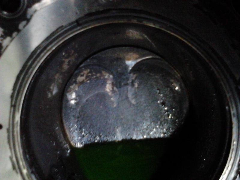

well i got the lifters out with a stronger magnet ( thanks beerhunter). I took off the head and have found out why my newly purchased superhawk is a newly puchased superproject. without taking the valves out it looks like all four are bent. They all look like they might sit at different levels, as well as maybe a little tilted. The piston has two divots where the valves hit the top by first sight look like they are about 3/32 in depth. and to top it all off the liquid in the cylinder (if you can see it in the picture) is ANTIFREEZE!!!! As far as i know i need to replace piston, valves, probably valve guides.
anything else......?
new piston for sure.....?
what with the anti-freeze....?
DAMN.............................................. ...................

BURNOUTS MC's Avatar
Joined: Dec 2011
Posts: 16
From: Orlando,FL
BURNOUTS MC is on a distinguished road
pics
Attached Thumbnails Bent valves???-2012-06-06-17.24.51.jpg   Bent valves???-2012-06-06-17.23.39.jpg

Yep looks like you did quite the number on it. Sorry to see that. Looks like all 4 valves are bent. You can get the keepers off the springs by placing a deep well socket on the valve spring retainer and smack it with a hammer. This will pop the keepers right out. Just be careful not to hit the walls where the buckets ride.
It's hard to tell in the pic of the piston if its really messed up or not. There are valve reliefs cut into the piston from the factory. Raise it to the top of the cylinder and clean it off real good and take some more pics. It may be just fine. The coolant probably just got in there when youpulled the head.
Once you get the valves out you can inspect the guides. Mine were broken and had to be replaced.
