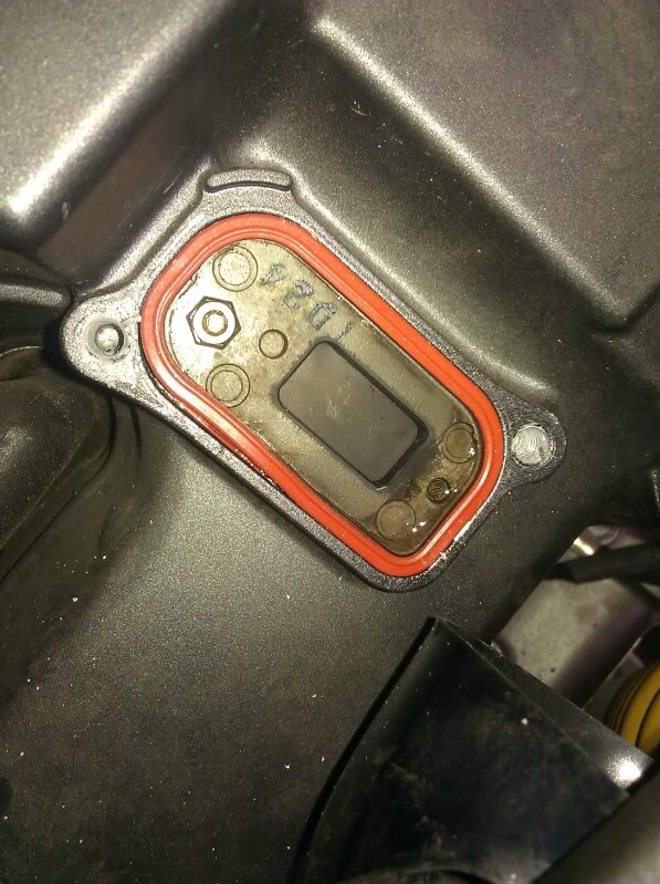

Upon digging back into the SH today I came across the PAIR valves and took some pics. This is a CA bike and the CA system has been removed. It looks like someone already capped off the valves:
Now, I am wondering a few things:
1. Did they do the job correctly? Is this tiny screw broken? If not how in the hell do you get that out?! I don't have any tools that small.

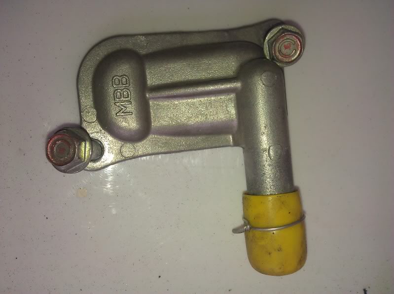

Is this flap that moves down supposed to be flipped so it will not open downward?

That entire unit surrounded by Orange will come out if you give a little force. There is a Phillips screw on the other side to remove the stopper, I chose to flatten the stopper instead of flip it.
But it shouldn't matter if the end is capped and there is no hose. Flipping the stopper won't change, it sounds like your carbs are lean.

AJA. Thanks I found that out once I took the second one off. Talk about feeling like a dumb ***! :-)
Steve. I may need to take you up on that. I flipped the stopper and so far it seems to have helped but not 100% solved the problem. When it comes to carbs I know Nothing so some supervision would be great.

James, Your more than welcome to come over. I even have a whole bunch of shims. The carbs on our bikes are very sensitive, and work best when set up well. I have a home made carb balancer than works great. Once you see how easy it is to remove the carbs. Your see its not a big deal. Stock our bikes come too lean, down low from the factory. This causes most of the carbs issues you and everyone else have when installing aftermarket pipes or a baffle-rectomy! Flipping the reed blocks should not really make any difference since the pair valve is capped anyways?
