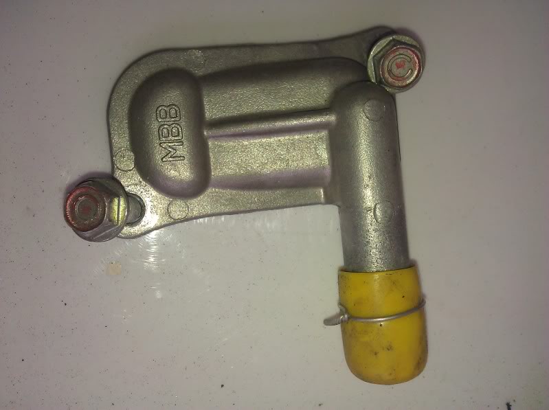

This weekend I did the Bafflectomy on my 03 stock exhaust. Immediately after completing the job and riding I noticed a small backfire issue that sounded like it was coming from around the carbs. I suspected detonation and started searching on here for related issues. I came across the PAIR removal thread and it seems like similar symptoms.
Upon digging back into the SH today I came across the PAIR valves and took some pics. This is a CA bike and the CA system has been removed. It looks like someone already capped off the valves:
Attachment 25023
Now, I am wondering a few things:
1. Did they do the job correctly? Is this tiny screw broken? If not how in the hell do you get that out?! I don't have any tools that small.
Is this flap that moves down supposed to be flipped so it will not open downward?
Attachment 25024
Attachment 25025
2. What do I do now? My slapping/popping issue has been ongoing since removal of the baffle. It is under steady throttle. Mostly noticeable between 25-40mph in 1st and 2nd gear. There is a hesitation that comes with each pop.
Any help would be great. The bike was running perfectly fine until removal of those baffles.
aja 02-13-2012 10:55 AM
That entire unit surrounded by Orange will come out if you give a little force. There is a Phillips screw on the other side to remove the stopper, I chose to flatten the stopper instead of flip it.
But it shouldn't matter if the end is capped and there is no hose. Flipping the stopper won't change, it sounds like your carbs are lean.

eersfanpilot 02-13-2012 11:48 AM
AJA. Thanks I found that out once I took the second one off. Talk about feeling like a dumb ass! :-)
Steve. I may need to take you up on that. I flipped the stopper and so far it seems to have helped but not 100% solved the problem. When it comes to carbs I know Nothing so some supervision would be great.
