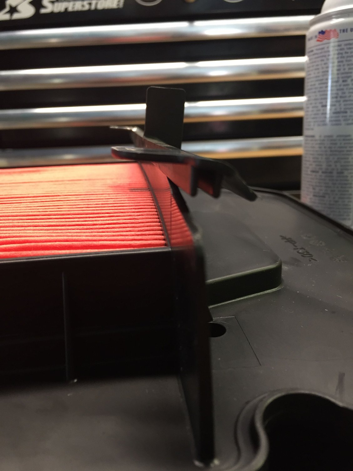

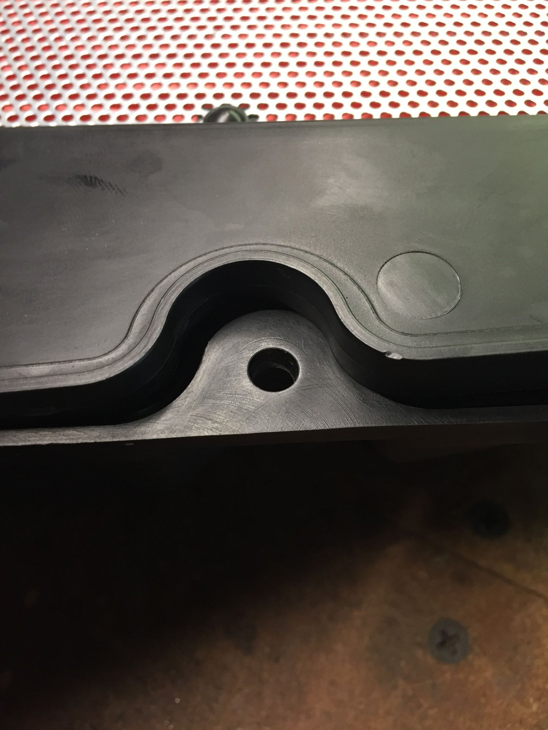

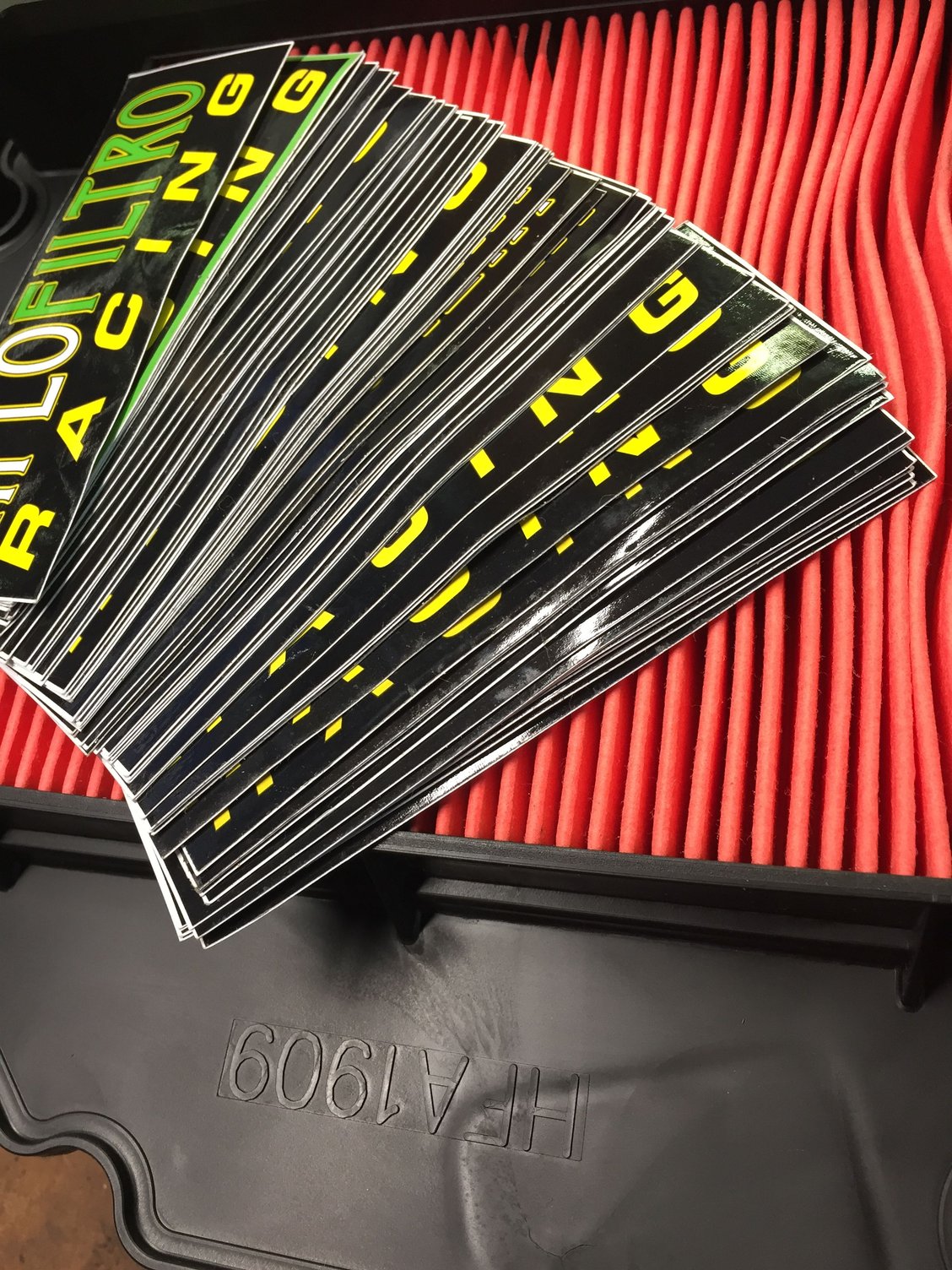

Old Dec 8, 2018 | 06:56 AM
Posts: 5,223
Originally Posted by niteridder64
I called the company that makes or maybe distributes the Hiflo filters and they want me to take pics, no problem. The company I bought it from sent me a return label and I ordered an Emgo, I'll see how that works.
This shows the piece from the airbox lid siting on one side and the warp of the HiFlo filter. Hard to see with a picture.
I have a LOT of experience using HiFlo products.
I reached out to HiFlo on social media and got no reply.

I never got the chance to take a pic of the Hiflo. I got the Emgo to my door very quickly and stuck it in to see if it fit and it was perfect. I installed the upper airbox to check that as well and inst. screws when I realized I forgot to snap a few of the Hiflo, just did not feel like taking it apart. My situation looked very similar to the pics Wolverine took. Installed new plugs and she runs just as good as before, mission accomplished.

Just send them mine.
