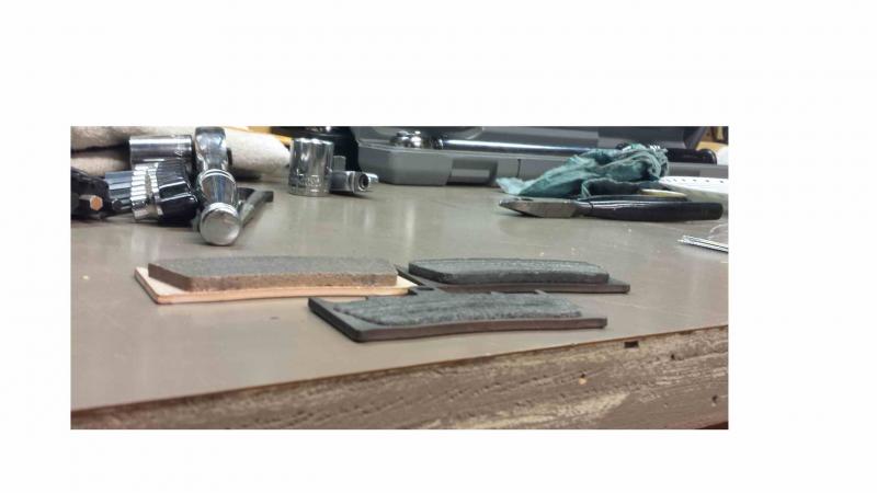

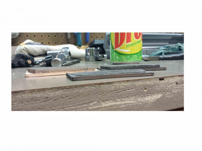

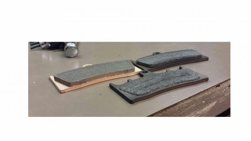

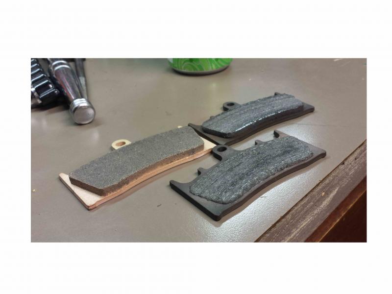

So I am working on my bike to ride which I have not done for 2 yrs just did my fork seals and brace and noticed my pads wore funny on the right side outboard pad. pictures will show much more wear than the the rest and compared to a new pad. as cash is super short right now the right way would be to get a rebuild kit. which is $90 bucks for both and in the UK. But I was wondering if anyone has had these apart before what I would like to do is take the pistons out and clean them up and put them back in how do the seals hold up. to try to get proper braking for the rest of the year. don't want to ruin a new set of $70 pads. But also I don't want to be without a bike so your options please.
Sometimes rust and crap gets built up on the clinder wall and kind of freezes the piston(s) in place. Cleaning it up and honing the cylinder wall will fix that.
So, what you want to do, is take the caliper apart. Then, run a cylinder hone inside the cylinder. Make sure you CLEAN the heck out of the caliper before you reassemble it. Now, the seal is another issue. If it shows no wear and it's not cracked, then I don't see why you couldn't use it again. Once it's all together, squeeze the front brake lever and wrap some rope/tape around it and the handle bar, then let it sit for a while. After a while, you don't see any leaks, then your seals should be fine.

If the seals are in good condition they can often be reused.
BUT
If the seals were in good condition, likely you would not need to remove the pistons.
If there is enough moisture, crap, corrosion behind the seals that piston is frozen in place, likely the seals are not serviceable.
bleed the brakes, see what comes out.. Use a hunk of wood or other even flat object in place of the brake pads.. Let the pistons come out a bit further then they did with the worn pads, but not much.. see what the pistons look like... see if they move at all.

The fluid is good I bleed the brakes 1 or 2 times a year except for the last two years I was unable to drive. I think I will take them off the bike and clean the piston parts that are exposed think I can put some wood in and pump the brakes to expose most of the pistons. before taking them off of the bike. Clean them push them back in new fluid and bleed I usually use the old fluid for the clutch as it gets black so fast. Does anyone know of rebuild kit in us.
