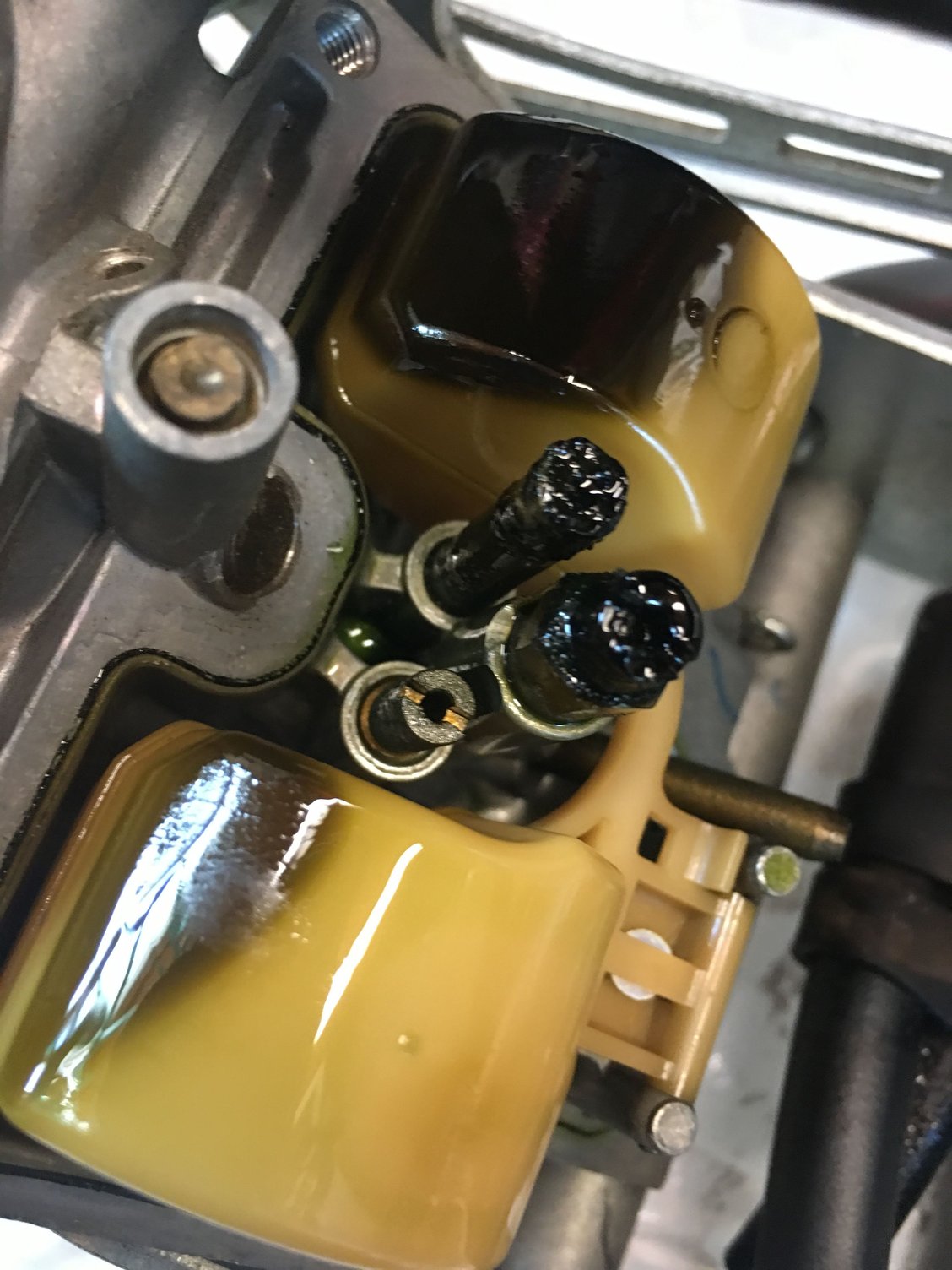

Hi all! I just bought a 1998 superhawk with 10,000 miles. She has been sitting for 10 years but is in absolute pristine condition. Unfortunately she wasn’t properly fuel stored. I’m relining the tank and have the carbs off, they are gummy and not rotten thankfully, and I’ve been reading all the posts about do’s and don’ts. Besides the obvious tires and oil is there anything else I should look at while it’s apart?

I'm gonna say firstly that those carb pics are going to give me nightmares.
For sure brake & clutch fluid, install fuel filters inline. Coolant of course.
Did I mention the nightmares. Geesh.
