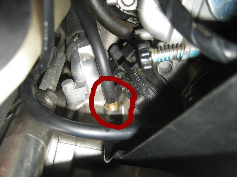

What the crap is this the front port? Why does this guy have something on his and mine is just a bolt.. How am I supposed to connect this tube to the bolt that lives on mine?
I think I am missing an iomportant piece of information. Am I supposed to connect some type of nipple?
Old Apr 17, 2011 | 11:41 AM
nykuryu's Avatar
Joined: Mar 2011
Posts: 238
nykuryu is on a distinguished road
im thinking he has made a fitting or found a fitting that fits in the hole.
Old Apr 17, 2011 | 11:45 AM
geekonamotorcycle's Avatar
Posts: 521
From: Tampa Florida
Ok I think I understand. I need some type of nipple adaptor for the front port and the vaccuum line that connects to the petcock is the where the T joint needs to connect.... So The T joint should be at an auto store locally but what size nipple adapter thing-a-ma-bob should I be looking for? is it a honda OEM part? funny this guy says he got the T Joint at halfords which is one of my clients. We manage their SAP systems from here in the USA and our china offices.
In any case how do I connect a hose to that front port without that nipple?
Old Apr 17, 2011 | 11:58 AM
superh1998's Avatar
Joined: Mar 2009
Posts: 182
From: chicago
Read the 5th post in this thread. You have to buy the fitting.
It was told to you 1.5 hrs ago.
Old Apr 17, 2011 | 12:04 PM
I'll make it even easier..... remove the cap head and install a #7 :
Honda, ATV Parts, Scooter Parts, Motorcycle Parts,CRF,CR,MX Parts, Goldwing parts

Oh ok so there is no way to do this without the part then? bummer. I will have to order it. In the meantime I tested my voltage @ 6k RPM and it looks to be 16~v idling it is around 13v. I am scratching my head about why that 2 day old bulb had its high beam burn out just like bulb that was in before.
Old Apr 17, 2011 | 12:09 PM
Posts: 521
From: Tampa Florida
Beautiful. I was just looking through the catalog for the local dealer trying to figure out which piece that is. Awesome I should have it by Friday so I can finish this. Until then I have my sync tool made and ready to go.
Geek... It would really make your own life easier if you tried using search once in a while... All the information is really easy to find, there are at least 3 different threads with the partno for the fitting in the first 5-10 posts... Armed with that, any Honda shop or dealer can help you...
But yeah, you can also get a non-Honda item, but in your neck of the woods they are partial to non-metric items, and the bike is all metric... Not a good match if you ask me... Me on the other hand, I could just buy a standard off the shelf item if I'd like too...
Old Apr 17, 2011 | 12:11 PM
Posts: 521
From: Tampa Florida
Tweety, I am jealous. The local auto shops just might have something though. What metric size should I be looking for?
Ooo nvm looks like a 6mm
