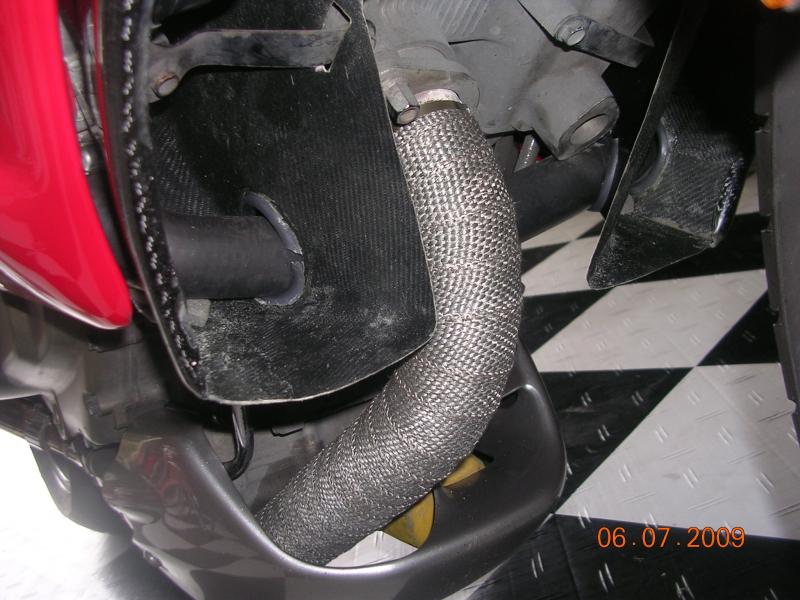

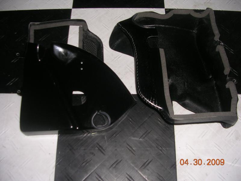

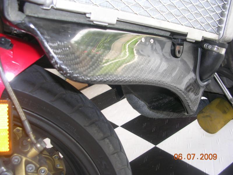

my fan used to come on all the time around 219 cuz riding in FL in the summer is hot, but I've added air scoops and running down the road at 5K rpm it holds around 185 no matter what the temp is outside, so in traffic at stoplights it will get into the 200s, but the fan doesn't usually ever come on anymore
air scoops???
got any pictures? might be something i should look into
Old Sep 15, 2009 | 08:09 AM
FL02SupaHawk996's Avatar
Fastest Color
Posts: 2,091
From: Lithia, FL
Originally Posted by joshuatest
air scoops???
here ya go!
Attached Thumbnails 01+ models - average running temp?-05-15-09-air-scoops.jpg   01+ models - average running temp?-06-09-09-air-scoop.jpg   01+ models - average running temp?-06-09-09-rt-air-scoop.jpg

Nice...
How pricey where those?
I took the pieces out of my stock fairings to see about fitting them to the RC51 fairings, but only looked at it one day and forgot about it. I'm gonna have to spend my next day off making that happen I think...
Nice...
They aren't cheap...I think I paid 325 Euros + shipping for the glass/carbon fiber set I'm running...here's the website & discussion about them on speedzilla:
http://shop.durbahn.de/shop/en/bikes...awk?bikecat=57
http://www.speedzilla.com/forums/hon...perhawk-2.html
